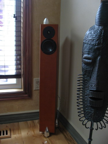

I had my Arro's always toe-in quite a bit. (Check out the picture) Just recently I have placed them straight. The are in corners about 10 feet apart, about 6 inches from walls. I think I like them better in this straight position!
Frank I know you have mentioned this once - I did not listen but now I like it. I may even play with mass loading again.

That's awfully close to the side wall. You might find it works better a little further away if possible.
Glad to be of help by the way! Incidentally, I said start from straight ahead and then just toe in ever so slightly if the image is vague. If it's not vague leave them straight.
Also, if possible, place the Beak on the front outside corner of each Arro. It was designed to work this way best.

OK, Pablo, you got me confused again. You don't show the speaker toed-in so I assume you are just showing us a "before" picture.
Why do you like them in their current position? Ten feet between speakers is quite a distance in most set ups. Have you tried setting the speakers up according to a real plan or did you just place them where they fit in the room?
There are a few advantages and many very strong disadvantages to the placement you show in your photo. I suspect there is virtually no staging outside the boundaries of the speakers, center fill can be a real problem for most speakers at such a distance apart, the early reflections I can guess at would be destructive to three dimensional imaging and contribute to substantial comb filtering throughout the frequency range of the speakers to name just a few potential downsides to your inidcated placement.
Don't take the above comments to be negative but just as a recommendation to consider what you have available to you and whether another shift in speaker placement might provide further improvements in sound quality. One of the few upsides to your placement would be an increase in midbass loudness due to the proximity of all three boundaries within the room; floor, side and behind the speaker wall. Depending upon your room dimensions this is typically a boost that exists within a restricted region of the midbass response and can result in a rather exciting sound if the music you listen to is heavily weighted in that range. It can also result in a muddy bass that lacks detail and pitch rendition plus a lack of clarity through the lower midrange where many vocals exist.
If you haven't set the speakers up according to a plan, why not try one and listen for any benefits that might accrue from such a move?

Sorry for confusion. This is old picture when they were toed-in, and much closer to the walls, and my wife just did dusting so she moved the beak. The Beaks are on front out corners. Speakers are now about 6 inches from back and side walls and straight(paralel to side wall). I will make another photo when I get home. The reason for corner placing and so far apart is protection. I have 6 years old boy and as we know things happen. Just a week ago my friend's 8 yeard old son playing, of cause by accident :-) made a dent in 3 months old totem WIND! On top of it to hide the damage so both speakers appear the same he made similar dent in the other. If not a good suction of Mielle vaccumm my friend would have a heard attack.
later on I will provide recent shot and room dimentions. Also there are biamped with totem tress, and running on Arcam Avr350 and squeezebox as a source.

Frank - the question is for the sound. I'd like an opinion for Arro's mas loading or not for the sound quality. Like I mentioned they are semi hidden so stability now it is not a concern. Like you've probably noticed on the picture I have installed claws on them as well. So would I gained anything by putting some silica sand in them or rather loose? Totem recommends 10-20 lbs in each cabinet for Arro's and on their web site the state:
"* If the "Totem Claws" are installed on the Sttaf and Arro then the mass loading option should definitely be experimented with."
