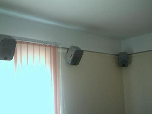

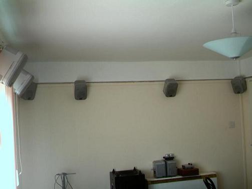

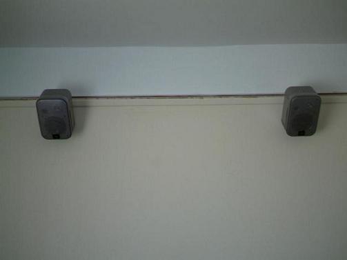

Username: Jblsince1989
Post Number: 113
Registered: Mar-08
I run the JBL control exclusively for the surrounds while JBL control 5 takes control over LCR. The Control 1 add nice insane warp around so easy to install and I've forgotten which film adds the highest level in the lower end. They can't reach down to far at high SPL db but with a little sub bass extension its seamless.
Around 80Hz upwards there good I'd hath to run further tests while LCR LFE.1 is muted.
Surrounds are wired in series and I've had no issues with there operating performance in the past 18 or is it 20 months now, hmmm, I forgot which year I bright them, think it was 2006?
In all there are x10 JBL control 1 x8 are fitted up at present and I still need to get at least another 10 or 12.

Username: Dmitchell
Ottawa, Ontario Canada
Post Number: 1186
Reminds me a bit of Ashley's array.
