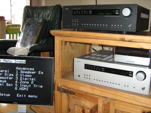

350 or 280 this is the question.
It takes few minutes to switch all the cables and play the same music on difrent AVR so it is really hard to tell if Arro's are much better with 350 vs 280. It is not like pressing speakers A or B buttons when testing difrent speakers (like I did some time ago with totem Staff and Arro's smoked them :-) )
Also - this is my settings:
Speakers large, no sub, everything at 0
stereo pcx
FX - Music
is this optimum with squeezebox as the source?
thanks
Pablo

Hmmm. Normally this would be easy. I'd just tell you to switch on the Direct button on both receivers and listen to some music played through the Arros, first with one, then the other. However, the Squeezebox is heaps better when used as a transport and allowing the Arcam to decode the digital stream, which means you can't use the Direct button (which switches off all DSP).
So I would switch off the Direct button and on effects just have Stereo - no FX-Music or anything like that. This cleans up the sound by giving you just the two channels (or 4 if you biamp) and as little processing as possible.
Setup both AV receivers the same. Play whole tracks through the AVR280, then swap to the 350. Play last track first for direct comparison, play one or two more (different album/different artist), swap back, play last track first etc. If it's not obvious in the first swap, it should be obvious in the second.

Thanks Frank. I did not have a patience to do it. I've put 350 with Arro's and 280 for HT. When I get Dreamcatcher 5.1 i will then revisit. For not I have crappy speakers in HT so Arro's will benefit from new 350. Most likely I will leave it like this because I listen music more then watch movies so 350 will get better use.
