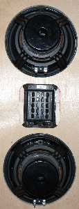

Gold Member Username: Timn8terSeattle, WA USA Post Number: 1192 Registered: Dec-03 | Many people call drivers "speakers". To avoid confusion a "speaker" is a system comprised of some type of cabinet, a driver or drivers and often a crossover. So, drivers come in all shapes and sizes and different functionality. Most are intended to be used in an enclosure (cabinet/box). If you just hook up a driver to an amp without a box around it (free-air) you can over-drive it. Over-excursion is when the cone and voice coil assembly exceeds it's intended distance of travel usually resulting in damage to the driver. Surprisingly, without the "spring" created by the mass of air inside the box the driver will require more amplifier power to create the same volume level you would achieve were the driver in a box. Hopefully you can recognize the quandry. If it requires more power to play loud but will likely be damaged if you try..well, it's just not going to work, is it? If you want to build a speaker system that doesn't have a box you'll need a driver that has enough motor strength and suspension strength to not need the "spring" an enclosure provides. Here's an OB I've been playing with. This is the front. ![]() |
Gold Member Username: Timn8terSeattle, WA USA Post Number: 1193 Registered: Dec-03 | and the back, without the wiring. ![]() |
Bronze Member Username: MikidIndianapolis, Indiana USA Post Number: 16 Registered: Jan-07 | Alright, I understood that a little better. Now, is excursion the distance that the cone can move? And over-excursion being to where it stretches too far? |
Gold Member Username: Timn8terSeattle, WA USA Post Number: 1194 Registered: Dec-03 | Basically, yes. http://electronics.howstuffworks.com/speaker5.htm Looking at the above graphic you can see the cone (or diaphram) is attached to the voice coil. The cone can move far enough to allow the voice coil to slap against the back plate of the magnet causing damage. |
