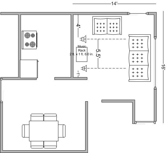

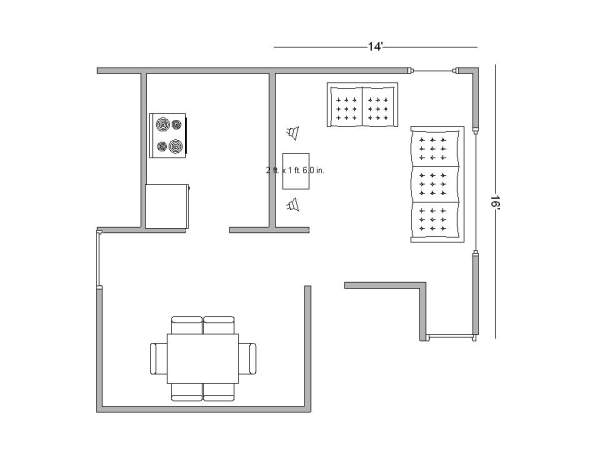

My room layout is as shown in the picture attached. It is not a closed room and that's what made me think about the 140s to 110s.
Bill would you mind sharing any specific reason why you are glad to buy 140s over 110s? If the 140s will provide as good surround sound as 110s I would probably go with 140s as they fill the room better.

Here's a few tips to optimise the sound from both sets of speakers. I have been dealing in Dynaudio speakers for over 10 years so I know a thing or two about setting them up.
1. They need space behind them. At least 2 feet.
2. Do not toe them in to start with. Let them shoot straight down the room. If you get a vague image, then just toe in 1 degree at a time and the soundstage'll snap into focus. You'll barely notice they're toed-in. This gives an expansive sound. One caveat - the side wall closest to the left speaker could impinge on the sound, so you could be reduced to toeing in a bit more but never more than 10 degrees. If you toe in much, Dynaudios pinch the soundstage into the middle. Very focussed, but not much in the way of bass resolution or fluidity (becomes more leaden). By having them firing square to the room, you'll open up the soundstage at the expense of some focus.
3. Looking at your diagram, they seem to be about 7 feet apart. If you can, bring them within 6 feet of each other. Also bring them so their front baffles are in front of whatever's between them. This has the added benefit of putting the left speaker in front of the side wall. You may not be able to live with this arrangement but it's worth trying to see if the results make as much difference as I suspect it will.
4. What stands are they on? If the Dynaudio stands, are you using the upward facing spikes on the stands or are you using blu-tac? I find that blu-tac gives me far better results. The speaker seems to have better grip and control of the lower registers. With upward facing spikes (on the stand), I find that they become a little disembodied.
5. Ensure that the speakers are absolutely level and that the stands do not rock at all. I use a spirit level to set up speakers - even during demos. Any movement in the stand is a source of vibration. Dynaudios put a lot of energy into the stand so get this right and it will pay off in cleaner sound.
Once you've paid attention to all the above, you should be able to discern significant differences in the speakers. Incidentally, for best results, the 110s and 140s will probably want to live in slightly different positions (sorry).

Frank my dealer suggested that Paradigm stands (23" height) would work well with the speakers. I agree with you that the challenge I have is that there is a wall by left speaker and open space by the right speaker.
I have attached an updated pic of my room with dimensions. I suppose in point 2 above you meant that the speakers should be facing straight rather than converging at an angle? and in point 2 you meant that the speakers should be less than 7 ft apart?
Any thoughts in addition to what you have shared is appreciated.
Any suggestions based on your experience regarding which speakers - 110s or 140s are suitable for my room?

Yes that's what I meant. Also, I notice that the rack is a HiFi rack? If so, you will reap rewards by placing it away from in between the speakers (that 4ft speace looks very enticing). I know it sounds strange, but I have found systems always sound better when the kit is not between the speakers. (Trust me, just try it if you can!)
If the relative position of the speakers is accurate, then the left speaker is almost proud of the side wall and I think that you should get good results. I wouldn't go less than 5.5' apart.
Actually your room is quite enclosed. I know there are open ways into the room, but the volume of space is quite well enclosed. I shouldn't let that worry you too much. You will be aware of te opening but it won't detract significantly in my view.
