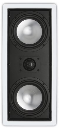

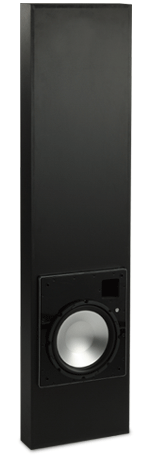

1. Sherwood Newcastle P-965 and A-965 1050 watt amp and pre/pro/tuner. Plenty of power, decodes everything, and 2-room use.
2. RBHSound Inwall Speaker System with in-wall speakers and in-wall subwoofer. A killer sound system. Their aluminum drivers are far better than the paper, poly-plastic, or fiberglass speakers on the market.
Not only can you maintin your budget but this system is better than any you've mentioned (IMHO). See the URLS below.
http://www.rbhsound.com/si10.shtml
