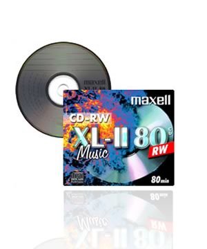

New member Username: DoorzPost Number: 6 Registered: Mar-06 | Just as an update, i have recently bought a 10-pack of Maxell XL-II80 Music CD-RW's to use with my Philips CDR 760 These discs do not work, although explicitly intended for audio cd-recorders. The OCP passes sometimes, recording commences and is stopped after 1-2 seconds, the track is not written to TOC. Inbetween i have also a second CDR 760 which reacts the same way, so i guess it's the discs who are are at fault. |

New member Username: Georg91Post Number: 2 Registered: Jan-15 | to Robert Beattie: Hi, I brought the same CD-RW Maxell. My first Philips CDR-775 dont accept this CD-RW and REC initializing fails. This problem is caused by a tired laser. There is only one solution to this problem : replace the laser unit and alignment REC end ERASE current for new laser (this procedure required the special Philips alignment machine). This service action is very expensive. Therefore, I bought another piece of CD Recorder CDR-775 (CD mechanism and laser is the same with CDR-600) in TOP condition. Now I recording on CD-RW Maxell discs witout any problems. (initializing, recording, finalizing and erase the disc) |
