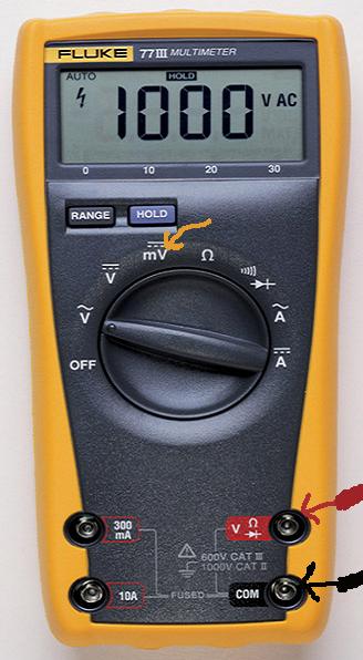

Gold Member Username: KeggerWarren, MICHIGAN Post Number: 2552 Registered: Dec-03 | Lovegasoline All of your advice from Jan has as usual been awsome! I work on gear quite often and deoxit is one of the best cleaners there is. (and yes cleaning the inside and all the switches is the first thing to be done) If you could get the service manual for your unit there are 2 things that should be checked/adjusted, dcoffset and bias. Now the bias you definatly need the manual for and if the unit sounds fine is probably within the ballpark. But the dcoffset can be checked without the manual and is a good general indicator of the health of the unit. The way you check this is with a voltmeter that reads in millivolts and hopefully has around a 200mv setting. 100mv or higher is to high, 50-99mv is acceptable but should be adjusted (if the amp has the capability) 25-49 is pretty good with 0-24 being excelent. what you are reading is both the positive and negative voltages in the unit and trying to get them equal which yes would read zero "in a perfect world". This voltage is a dc voltage being measured at the speaker outputs on the back of the unit with the input selector choosing a an input other than phono that has no unit plugged into it and no speakers that are attached. (make sure the meter is set to read dc volts not amps) If you don't have a meter or are not comfortable doing this check I would suggest that you take the unit to someone you know that could do this for a very small fea if not free! This dcoffset causes undo distortion and can be an indicator of the health of some of the caps/resistors/transistors/whatnot in the unit. Some units do have an adjustment for this and over time may need a little tweaking. Others that do not have this adjustment and if the reading is to high then the input transistors will more then likely need to be replaced with a matched pair. But if you do this test and the dcoffset is fairly low you can feel pretty comfortable that the unit is in pretty good shape. Not all units can you do this measurement on as in a MAC that has output tranformers the dc is blocked and the same goes for a cap coupled unit. But the vintage of your unit should have all these abilities. Take care! And glad to see another vintage unit being found and used as most of them are well built plus much better then what you would find today unless you spend an arm and a leg on something being built in todays market. |

Bronze Member Username: LovegasolineNYC Post Number: 12 Registered: Jul-05 | KEGGER, Unfortunately I do not have a copy of the A-700, and do not know where I would begin to find one...I looked on the web but came up with nothing manual (therefor the bias test will have to wait). I'd like to have the manual in general to better understand the specs of the amp. I did perform the dcoffset test: Using a Fluke #77-III Multimeter, set to millivolts DC, I performed the test on the amp. The amp was powered up, all input devices were physically unplugged from the amp, all the speaker connections physically disconnected. The speaker selector switch on the amp was set to 'on', input switch set to Tape #1. I got a reading of +1.6 milliamps (actually, the meter read "-1.6") this is with the common (blk) probe on the (-) speaker output, and the red probe on the (+) output [and of course, blk probe to common input on meter, red probe to Voltage Input]. Does the data appear correct for the test? Thanks a bunch for the testing info. I've been reading through allot of past posts on the forum and come upon your contributions frequently...all part of my learning curve. The wealth of knowledge here has definitely inspired me to put forth the effort towards attaining better sound. Cheers, Neal |
Gold Member Username: KeggerWarren, MICHIGAN Post Number: 2575 Registered: Dec-03 | Lovegasoline This has me puzzled a little bit. "got a reading of +1.6 milliamps (actually, the meter read "-1.6") this is with the common (blk) probe on the (-) speaker output, and the red probe on the (+) output [and of course, blk probe to common input on meter, red probe to Voltage Input]." You say milliamps not millivolts. I REPEAT DO NOT SET YOUR METER FOR AMPS AND THEN PUT THE LEADS ON YOUR SPEAKER OUTPUTS, SETTING YOUR METER TO AMPS IS A DEAD SHORT ACROSSS IT AND YOUR AMPLIFIERS SPEAKER TERMINALS WILL NOT LIKE THAT AND CAN CAUE VERY BAD THINGS. so hopefully you meant millivolts and had your meter set correctly and the terminals on the meter itself plugged into the right thing (volts not amps) also you say you got a reading of 1.6 (neg or pos does not matter) it sould be different for both channels like -1.6 on the left and maybe +12 on the right. so again make sure the meter is set to volts on a scale that will read millivolts, the leads on the meter are in the volts not amp plug ins and check both speaker terminals from the terminals you have selected as on by the amp. If you are not measuring from a terminal that is live (as in amp set to spk 1 and you measure there) you will get no reading from the unit as it is putting nothing to that terminal. If you can get a good pic of your meter setup the way you think it should be I can more than likely verify that it is correct! |
Gold Member Username: KeggerWarren, MICHIGAN Post Number: 2576 Registered: Dec-03 | Actually here is a pic of your meter and I have marked where your meter probes should go. DO NOT! put the probes in the other side as that is for amps and would be a dead short. Also it looks as your meter does not allow you to select the range but does give you a millivolt setting that is marked in yellow and from the description of your meter it should be able to read low enough with no problem. ![]() |
Bronze Member Username: LovegasolineNYC Post Number: 14 Registered: Jul-05 | Kegger, My error. Milliamps was a typo. I tested with the meter set to millivolts (no additional range selction is needed on the meter) and the probes connected correctly (yup, that's my meter & it was setup as your arrows indicate). Again, all input devices were removed, the input switch was set to Tape #1, speakers removed, 'Speakers A' switch set to the On position, 'Speakers B' set to the Off position. I re-tested. Initially, ths is the reading I got: Speaker A Left Terminal: 9.1mv Right Terminal: 2.2 mv I kept removing and replacing the probes and retesting, and the reading would fluctuate slightly each time, but in the end it seemed to settle around the 2mv +/- reading Left: 2.3mv Right: 2.1mv For 'Speaker B' left & right terminals, a similiar 2mv -2.5mv reading. ??? |

Gold Member Username: KeggerWarren, MICHIGAN Post Number: 2587 Registered: Dec-03 | Yes good results, I'm glad. Generally the reading is a little high when the unit is first switched on then it will settle down, sorry for not mentioning that. Your amp is probably in darn good electrical shape then. Congrats! |
Bronze Member Username: LovegasolineNYC Post Number: 17 Registered: Jul-05 | Kegger, Yeah, the high reading/low reading was a little disconcerting at first. I'll do the bias testing if I ever manage to get my hands on a manual. Next stop.....speaker upgrade. Thanx a bunch for the generous help! Neal |
