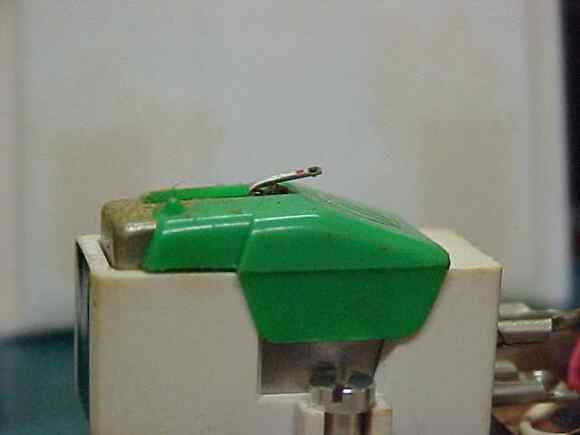

AHA!!!! Cartridge malfunction!!!! (used up)
Username: Scalemodeler
Winder, Georgia USA
Post Number: 8
I'll get a new one Monday....
This one's seen better days!!!!

It looks like the stylus has been bent back through about 150º.
A new stylus might be the first thing to try, depending on whether you want to keep the cartridge.

John A.,
Think I'll just get a whole new cartridge....the stylus is difficult to bend at the correct angle....

Billy; good idea. Take a look at the new one, with stylus in place. I think you find that someone has done serious damage to that old stylus - it is not just "used up".

my kids were very good at destroying carts. the age group 2 to 6 in particular.
