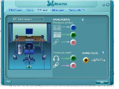

I use now te same stereo cable for digital as well that the same jack output, I simply go in Realtek menu to activated the output on "digital".
I use one of both RCA output.
Unfortunatly this output not work for all files, usualy it work fine on Mp3, wave, midi, AC3.
