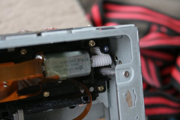

I too appeared to be suffering from the same problem as many others i.e. CD unit was skipping through CD's then saying no disc. After tapping, shaking and generally proding unit with no success, decided there only option was to take the unit a part to find out the cause of the problem.
From what I observed, the mechanism ejecting the magazine worked fine but, the cd loader was not working. Therefore, I carefully disassembled unit. Not too difficult, some screws to each side, gently remove casing (plastic clips), remove anti-vibration mounts and springs. (advice if you are going to do this then make sure you a) allow time to take our time and b) have a clear desk to work on).
Once you have unit apart turn upside down and you will see two motors and drive gears. One drives the magazine loader the other the CD loader. On my unit I noticed a slight misalignment of the worm / wheel drive gears causing them to jam and cease the drive hence the problem everyone is experiencing. Gently using a screw driver I realigned the gear meshing. Immediately the unit started working. However, it failed again on multiple testing. once again, I released but this time I checked the tightness of the gear mount and found it loose. I realigned worm & wheeel gears and retensioned monting screw. This time I tested unit numerous times and all worked fine. I reassembled unit and reinstalled. So far so good unit back in action.
So based on my experience I would say issue is more to do with the CD loader drive mechanism (worm / wheel) than the micro switches I found nothing wrong with them.
Clearly if your unit is still in warranty take it back and don't interfere with it. If not, and cost of professional repair uneconomic then you may wish to check the above.
I took a picture of the offending mechanism but unfortunately the size limit would no allow me to load to this bulletin board. No doubt though interested partis will identify mechanism and determine whether issue is same for them.
I hope this helps, good luck.

This is the photo link which shows all the problems you guys have faced, I just solved out the problem. Special thanks to E.
http://www.flickr.com/photos/52921635@N00/40347501/

Check out the photo link posted by George. It shows the two wheels that were mis-aligned on my unit.
Using E's instructions things are now working perfectly. Took about 40 minutes to fix (but probably a 2 minute job for some-one who knows what they're doing!).

Hi. I recently had this problem of a jammed worm gear, which was preventing the loading mechanism from operation (although the CD cassette could be loaded/unloaded OK). If you are happy with a screwdriver, it's an easy thing to unjam the worm gear. I also tightened the screw which holds the gear mount, but it was not really loose; have changed CD a number of times since fixing with no problem, but I suspect this may not be the last time it happens. I have also posted some of my own photos for you right here.
Username: Tomba
Registered: Apr-06
Here are the images:
unit removed from case
underside showing worm gear at top right
close up of worm gear

I have the same issue of not able to load Cd, and fixed by opening the case to realign the screw/gears. However, my cd changer skips when i go through bumps. I am not sure if because i didn't put 4 dampers correctly. I also have a pair of small springs of the height of slightly less than 1/2 inch that came out from the cd changers that I don't know where they belong.
Please advise. Thanks.

Hi Scott,
There are four little pegs that should each fit into the center of the four dampers. The little springs go on either side to suspend the deck inside the case. Look on either side. The spring should have a ring on one end bent away from the rest of the spring, and on the other end a little peg sticking out of a circular bit that has a groove all the way around. Hook the ring to the hook on the inside deck, the circular bit with the groove goes into the curved slot on the inner frame. Hook it into the first part, then stretch it, sliding it into the third notch or so. This helps absorb the shock and prevent the skipping. Hope that makes sense. In Tom's first photo, you can see the part where the peg hooks in, inbetween where the two dampers go.
Once this is in place, you'll fit the outer shell over the whole thing, being careful to fit the peg into the cutout for it.

Also, thanks everybody for your input. I was having the same issue, and fixed it by aligning the worm/wheel gear set as described. This actually happened once a couple years ago and I'd forgotten all about it--I think I referenced the exact same thread. I remember the great photos! Thanks for taking the time; you guys are heroes. You saved me at least a couple hundred bucks... plus I'm leaving for a long road trip in a couple weeks and would have been very bummed to have to make do with other forms of media.
Thanks a million!
