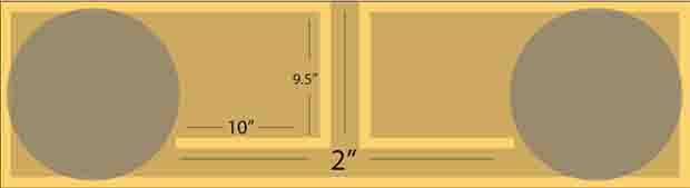

Hi guys new to the forum, searching for some help on a box that i want to
build, i own a ford sport trac 2007 already installed the stereo amps and
the subs 2 rockford p3sd4 but the box is to big and the subs hit the back
of the seat and doesn't sound right so i took measurement of the area to
do this right an the size that works are W48 H13 D4, now my question is the
mounting depth of the subs it says 3.65 inches i don't know if that
enclosure is gonna work for me since i have limited space i'm only getting
3/8 clearance between magnet and mdf wall here's a picture of the design
with a port if anybody could tell me if this works it will be great help,
