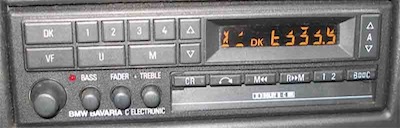

I have a problem with bmw radio Bavaria C electronic BE 0728.
Radio working well for 7 years... but in this day the display say:
And no CODE.
I can not enter the code. (I have original code card)
I have wait many hours with the radio +12 connect, but nothing to do.
I have try to reprogram the eeprom code BAW574252.... nothing!
I have try to replace the BAW with a new 24c01.... nothing!
Anyone can help me to solve this problem?
