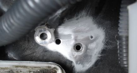

Username: Joe1234
Post Number: 1806
Registered: May-09
I come around on here every few days sorry,
Sanding the chassis at the place your ground terminal will be bolted at.
Username: Joe1234
Post Number: 1807
Registered: May-09
Example:
This establishes a true ground to the chassis, it eliminates a possible source of noise and improves amplifier efficiency.
