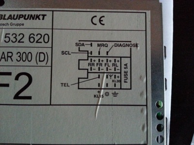

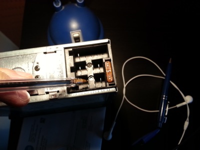

I removed the car and there is a pin marked as "Tel".
I assume is the telephone pin.
What is I bent or break it?
Thanks
Toni

Of course I mean that I removed the radio
The pin i show in the picture is marked as "Tel".
What if I bent it or break it?
Will it fix the problem?
Toni

Here you can see the drawing that the pin is marked as Tel
