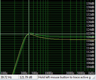

Ok so this is a plot just to have an idea (cabin gain effects excluded):
The optimal recommendation is 4@34Hz for the SXX 1000W power (green curve).
and for the couple of Alpines I used 4@33Hz 1200W power (yellow curve).
At lower frequencies you could get up to 3 extra dB of acoustic power due to increased sensitivity of nearby drivers working together.
So I guess I would choose the couple of Alpines since they will peak a bit lower and may get somewhat louder but it's a *close call* when using the boxes specified above. Also assumes that your electrical is optimal and your amps are properly set.
What is definitely correct is that the tuning of that enclosure is too high peaking at 52Hz. It must sound like loud junk.

Thanks for the great information. where did you go to get that graph?
Username: Glasswolf
Columbia, South Carolina America
Post Number: 14660
Registered: Dec-03
http://www.linearteam.dk/default.aspx?pageid=winisdpro
