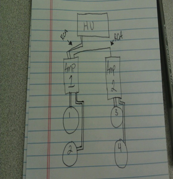

I drew how the wiring is going to be set up, im not completely sure that the subs can be hooked to the amps this way Upload

I believe that RCA setup on the amps is just a pass-through for the signal. you'll still need to adjust settings on each amp as if they were not daisy chained together.

Josh you are not wiring the speakers like the bridged connection they show on the manual.
The amp you connect the RCAs from the HU will act as the master, then there is a mono signal that is connected to the second amp as instructed. That would be the slave amp.
I don't see anything confusing on the connections they show.
