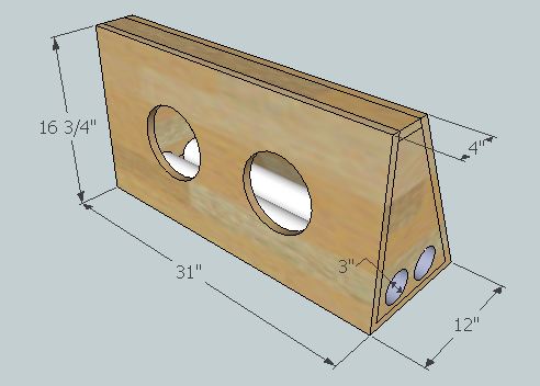

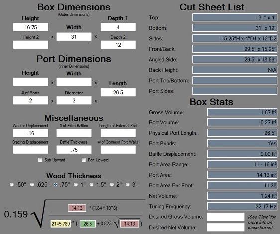

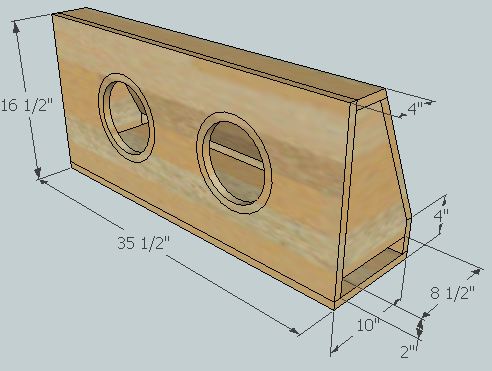

Ok so based in your first slanted box but using aero ports here is a box with 0.62 cubic feet net per sub. There are no real disadvantages of side firing as long as there is airspace in front of the port:
1.24 cu.ft @ 32Hz
Port length is 26.6", port area per cube of net volume for aero ports is recommended to be 9-13, this scores 11.4 which is adequate for daily use with a slghtly lower F3.
Done just for fun. If this is not suitable I will try a slot. Bear in mind that I would tune higher to 34 at least.

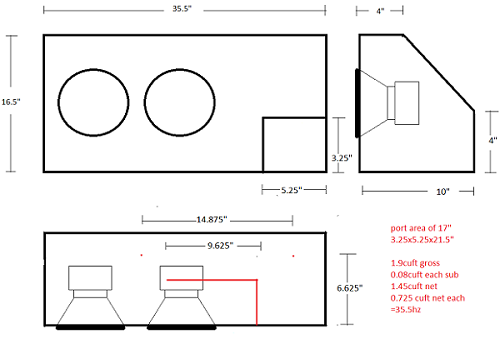

if i go back to first box
as you have drawn
your dia are a bit out but still close
16.5(h)x 35.5(w)x 4(td)x 12(bd)
1.92cuft gross
1x5" aero port x 27"+flare
sub displacement 0.8ea
should give me 1.38cuft net @35hz
or just fit 2x3"x26.5 in the same box of 1.92cuft gross
and have 1.5cuft net @31hz
Username: Joe1234
Post Number: 1345
Registered: May-09
Ok for the drawing above:
I can keep giving suggestions just let me know what you need, if you can't do 16.75h also let me know

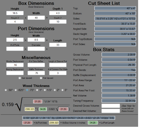

Both of theis box would be slimmer
The slot port is easier/ cheeper to build as freight on 2 3" ports from psp
Is $80 + the ports them self
That angle on back of box is 1" in 2"up
So if i wanted a slighly bigger port and stay at 2" up
Box would be
16.5(h1) x2.75(h2) x35.5(w) x4(td) x 10.5(bd)
Port 2x9
Cant work out length as im at work
But that gives a better port-cuft
Another thing am i better to put subs evenly accross the box or both 2 one side over port as in stanard boxes

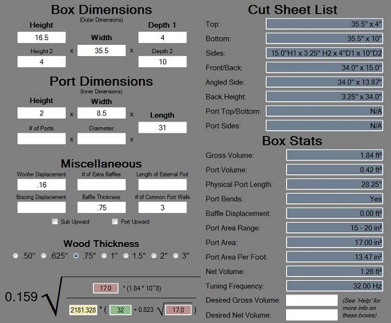

this is the bigger i could build with a flat on the side
it will be hard as the top of port as side all meat in the same spot
but an easier one would be

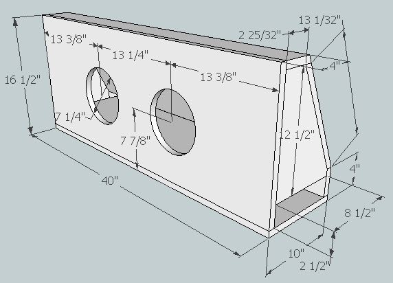

Username: Joe1234
Post Number: 1349
Registered: May-09

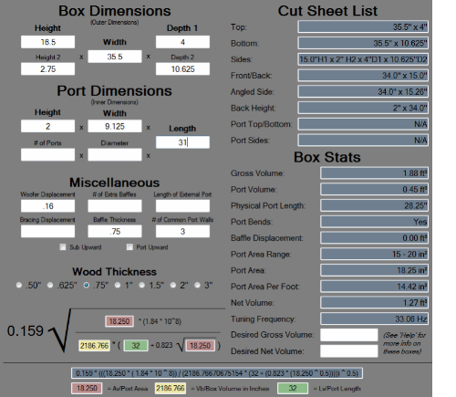

Ok if you are willing to go to 0.7 cubes per sub which is nearly the top recommendation (for V1), you need to stay not much above 20% of rated power to avoid bottoming out the subs, and 33Hz is nice, people who like overdriving a lot those subs are doing 0.5 cubes per sub @ 35-36Hz to get really loud.
Also 40 wide?... well if you can fit it ok.
If you were going to compete or something I would do an excursion plot but I guess that's overkill for this.
Username: Joe1234
Post Number: 1350
Registered: May-09
And regarding the sub position you need to be careful not to make the holes without checking mounting depth, are 5 1/4 deep, when you decide on the specs I could check it for you.

ive done the maths
@ 7.5" from base to centre of sub, it will touch back wall
and @6.5" from base to centre of sub it will touch port wall
(7"mag@5.25 depth)
so the centre of sub will be between 6.5 and 7.5" from base
as i dont have any programs to plot this, is there a good ball park i should work to, as small boxes are not my forty,
i can either fit closer to rear or closer to port
+ is it better to fit both subs off set to one side, either towards port opening inside of box or away
or just anywhere that looks good ie divide box by 3 and subs equal to each other
Username: Joe1234
Post Number: 1352
Registered: May-09
Ok John So I answer with a pic all your questions, everything is already checked to fit VERY important the height of the center of the sub cutouts:
I wouldn't like to build this thing though

if it less it will fit as is,
but ill see when they contact me back with del times and availability
