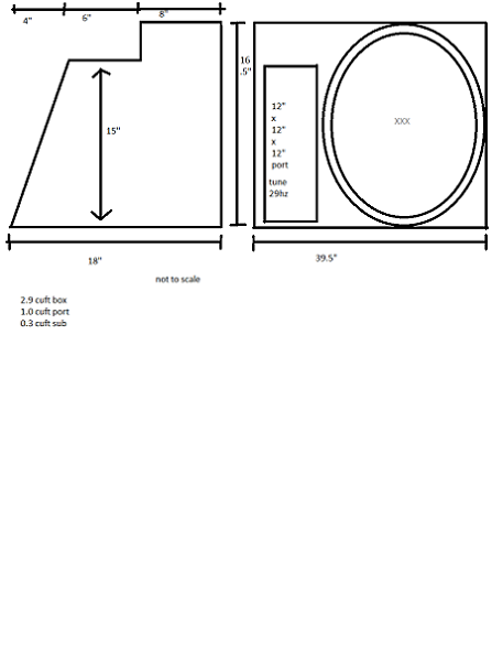

done some sums
2.9 cuft box
1.0 cuft port
0.3 cuft sub
1" mdf
port 12"x12"x12" tune to 29hz
sound about right

Username: John253a
Aust.
Post Number: 106
Registered: May-11
Username: John253a
Aust.
Post Number: 110
Registered: May-11
if i tuned to 35 with
12x12x8 port ill get around 3cuft

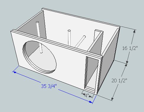

I did a box for a RE XXX 15" recently, it meets Re Audio spec, take a look:
Enclosure Specifications:
Fb = 33 Hz
Vb = 4.013 ft^3
External Height = 16.5 in
External Width = 35.75 in
External Depth = 20.5 in
Port Width = 4 in
Cut Sheet List:
* All Dimensions in Inches.
* Wood Thickness is 3/4 for all Parts.
External Enclosure Parts:
2 x Front & Back (3 parts) = 35 3/4 x 16 1/2
Left & Right Sides = 18 1/4 x 15
Top & Bottom = 35 3/4 x 18 1/4
L Port Internal Assembly Parts:
Front to Back = 14 1/4 x 15
Extension = 8 1/4 x 15
Username: John253a
Aust.
Post Number: 111
Registered: May-11
So port length is
15x4x26"long
Ill run it throught winisd and see how close it is to what i can fit
I can go out a bit more on box but i still want a box
I work your out to be close to 5.6cuft no port/sub
So my 4.3 is a bit shy
Any recomendations on port size for my odd shaped box
Unless i run port accross front and out front i cant go bigher then 14" high and 14" long width is no ploblem
It would like going in 4" and accross 20" and back again 8" and 15" high with the opening at front
An s shaped port
Ill draw it up when i finish work and show you

WinISD can do square ports but slot ports require end correction calculations in most cases.
The box I left you has 4 cubic feet of internal volume not 5.6.
Does that box you are planning on need to be that shape?
Username: John253a
Aust.
Post Number: 114
Registered: May-11
yes it does to fit behind back seat and under back parcel shelf,
if i go out any further i wont be able to access batteries and spare tyre as the factory battery is located in rear wheel arch well inside boot
