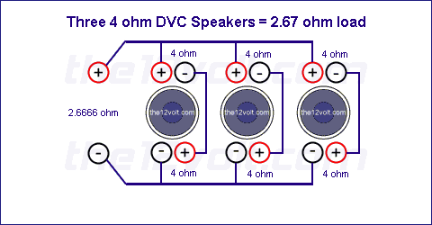

Secondly, lets take note of what you already have purchased. Your JL Audio 12W6v2 Subwoofers are rated at 600 Watts RMS and come in a DVC at 4 Ohms. With three of these together, we are looking at a total of 1800 Watts RMS wired at 2.67 Ohms (series/parallel) or wired at 6 Ohms (parallel/series). Your Alpine MRP-M2000 is rated for 1500 Watts RMS at 4 Ohms and 2000 Watts RMS at 2 Ohms.
With this information, I would highly suggest looking to see if your JL Audio Subwoofers are wired correctly to the 2.67 Ohm configuration. Example below:
If your JL Audio Subwoofers are wired correctly, I would suspect your current Enclosure to be at fault. I am not sure what type of Enclosure you have, however I would make sure that it follows the recommended specs that JL Audio preffers.
