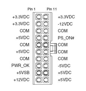

Take a look at the pic:
Tie the PS_ON to the adjacent COM to turn on th power supply then use a +12V output (yellow) and a COM (which is ground) to connect to the AMP. To turn on the amp you will need to connect the REMOTE ON to the + 12V also.
Since PC power supplies are not designed to take steep surges I recommend a 750W branded power supply not generic ones.
Bear in mind that you are doing this at your own risk. start with the gain at minimum and all tone controls to 0 (defeat) both on the source and the amp.
Good Luck.
