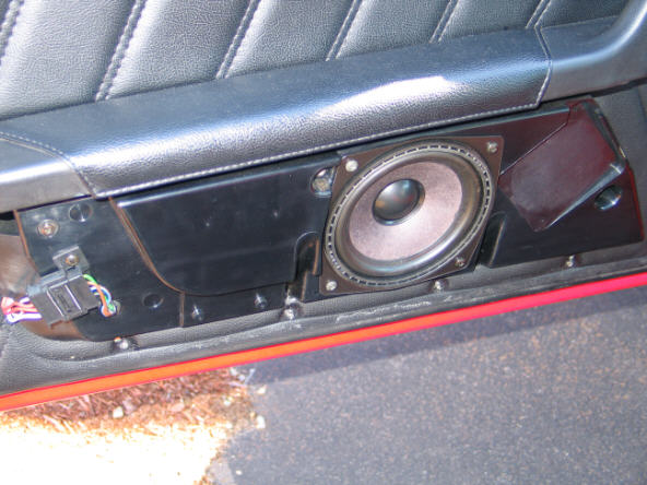

New member Username: RobbyTN Post Number: 1 Registered: Jul-04 | I'm TRYING to build a VERY simple & basic system w/as FEW speakers, etc, as possible, for a Porsche 944 Turbo S- these cars were never set-up for decent sound... The Turbo S had a 5.25 woofer w/sep 3" mid & sep tweeter up front- the 5.25 & 3 were underneath the armrest (tweeter up top) & the rear of the car had a 6.5" w/sep tweeter under the rear 1/4 window. MY car has 6.5" Infinity Kappa coaxes in rear w/Infinity 6800CS (6x8 w/sep tweeter) up front- the 6x8's are under the armrest- the bass sucks- the factory Turbo S stuff was about as good (w/much smaller speakers & MUCH less power)- I'm running the new speakers off an ADS PQ10 4-ch amp- I have a Kenwood 7017 HU. I HAD an '89 Integra- had 4- 6.5" 50w Bose coaxes w/Clarion Pro Audio HU (from '95)- it had decent bass- I'm sure that w/a decent amp & slightly stronger speakers, it would have been great, so, I don't believe it when someone says I have to have subs to get decent bass- I could FEEL the bass in my seats in the Integra, so, I definately don't need subs for what I want. Does anyone here know anything about how to get some decent bass out of the FRONT speakers of a 944 Turbo or Turbo S? The rears are doing ok- much better than the 6x8 seperates- this is VERY irritating- any input would be greatly appreciated... thanks a lot, Robby |

New member Username: RobbyTN Post Number: 2 Registered: Jul-04 | Matt- thanks for your help... I've read a bunch of your replies- you obviously know a TON more than I do, so, I mean what I'm about to ask w/all-do-respect, but, I'm afraid it's not power- I'm thinking it's enclosure area- I say this b/c the Integra is a VERY similar shaped car & w/less than 1/4 of the power w/much weaker speakers, it gave pretty good bass(?). Also, the PQ10, so I've been told, is very underrated, BUT, IF what you are saying is the case, I THINK I would rather go w/dif speakers & KEEP this amp- it is fairly small for an amp (the reason for it's lower power output?) but, is STILL WORLDS above anything else I've ever had, but unfortunately, I'm getting LESS bass from it than anything else too... Also, the 6.5's seem to have decent bass, &, they're #'s are less than that of the 6x8's- in other words, the 6.5's should need MORE power than the 6x8's. What I'M thinking is that it's a case of area- the area underneath the armrest is less than 2" deep max & ~10" long- it actually tapers, so that at the bottom, it is actually touching the base of the door panel, so that there is no depth. I'd almost have to show pics, which I DO have, but, am not sure how I would ever post them(?). the original 5.25 actually gave as much bass off a stock HU (in this small enclosure) than my ADS amp gives through the 6x8's here- I picked the 6x8's for the front- I tried 6.5" CDT CL61's, but, they would not fit there- 6.5's are just too big- I wanted a seperate of some sort for the front w/as much cone area, for bass, as possible... what do you think based on all this? ALSO- how does one hook up an amp, speaker to speaker, in order, for a normal car? I mean, I have ch #1 as front left, #2 is front right, #3 is rear left, #4 is rear right- is that the way these amps are SUPPOSED to be set-up to run speakers? I've got a prob here: when I fade the power full rear, I can balance to either side & get full power out of each speaker, as I should, BUT, when I fade full front, I can get full power out of BOTH speakers by balancing full right OR to the middle, BUT, when I balance full left, I get no sound from EITHER front- it HAS to be a wiring prob, but, I can't figure it out- the brigding capability is #1 & #2 together, AND, #3 & #4 together, but, I'm not touching this at all, as I'm simply trying to run all 4 speakers off the amp.. any more input would be greatly appreciated... Thanks a lot Robby |
Silver Member Username: MattlBolingbrook, Illinois USA Post Number: 239 Registered: Jun-04 | While some resonance would create more "ambient" bass, I'm still 100% confident it's a power issue. Remember, speakers are mechanical devices, and what we usually refer to as power is actually work. Your voltage cannot make the 6x8s work as designed. Assuming they have a 4mm Xmax, you're barely going to be pushing 1mm at half-volume and that power. That's not enough to move air and generate deep bass. Seriously, try bridging the amp (shouldn't take but five minutes). I'll bet you prove me right. I'll also bet your rear 6.5s are < 60W RMS. Looking at that PQ10, it's pretty confusing. Are you sure you don't have Bridge 1-2 on? -Matt |
