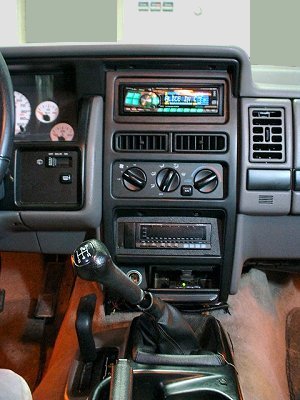

Platinum Member Username: GlasswolfColumbia, South Carolina Post Number: 14433 Registered: Dec-03 | meant to say, I did a similar thing with an old Jeep I had. below are: 1. front door midrange driver 2. the tweeter with the OE grille removed 3. back door with coax 4. dash with alpine head unit and EQ. |
