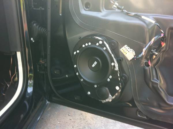

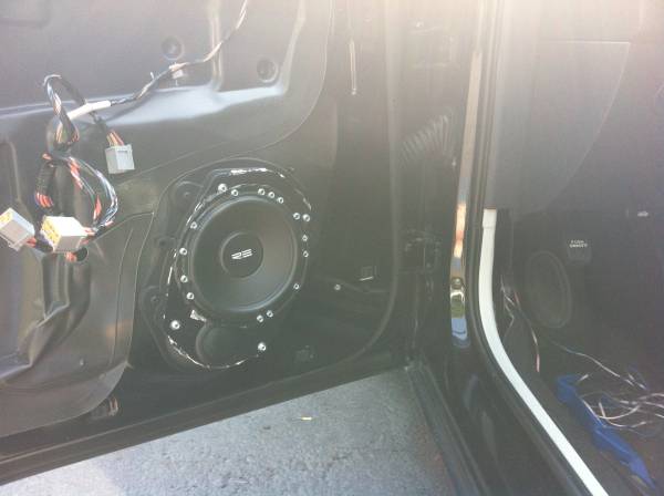

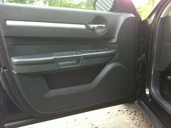

Components installed in the doors. The silver is dynomat, I always use it between speakers and baffles. Used adapter brackets to mount the 6.5" and tweeter in the factory 6x9 opening, but I had to mod the adapters on the grinder quite a bit, the holes were not big enough for these speakers. lol.
The door looks completely stock with the panel back on.

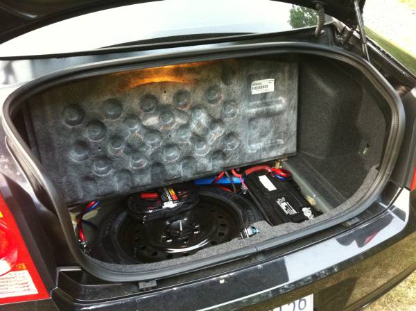

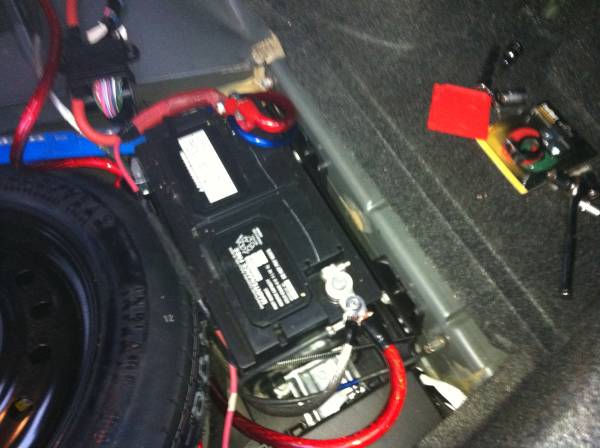

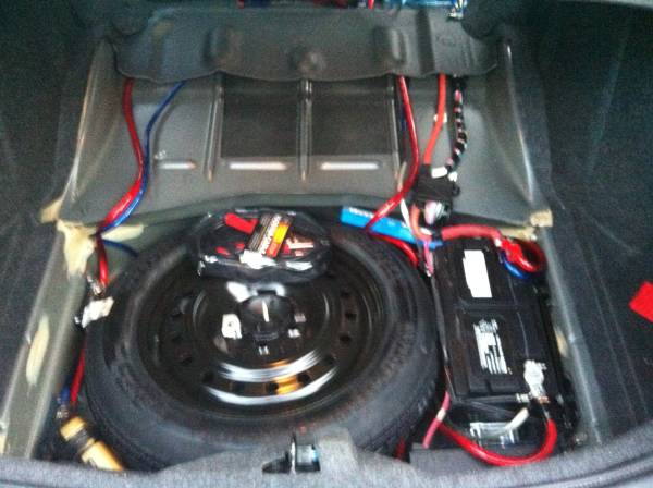

View of the battery / spare tire compartment with the trunk liner still out, fuse blocks mounted on the left.

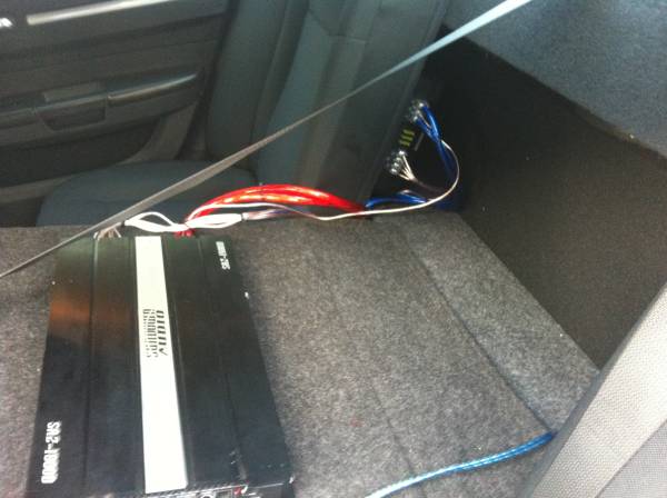

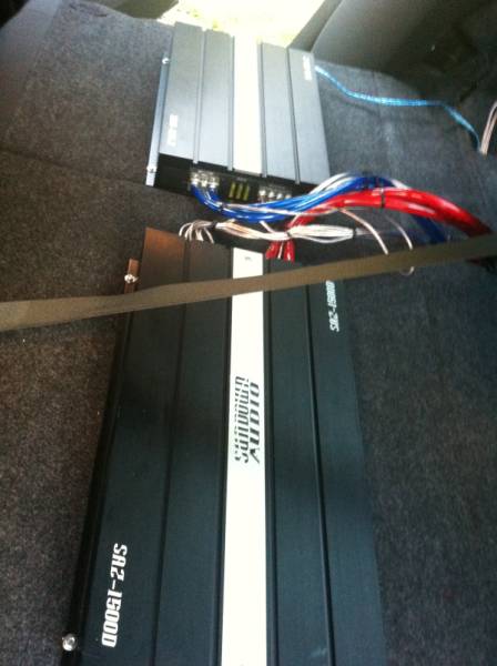

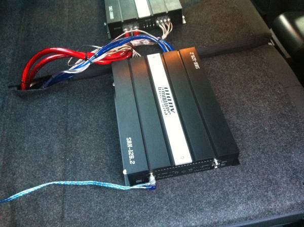

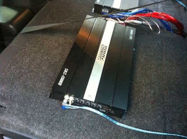

Amps on the back of the seats.

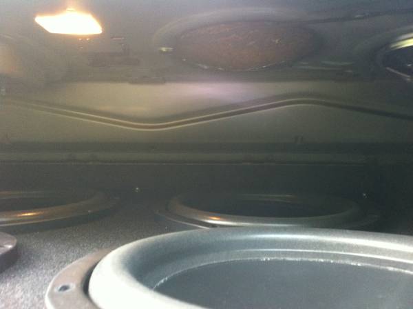

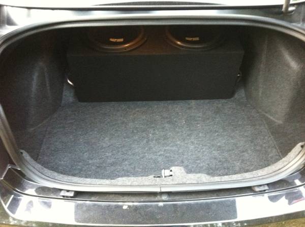

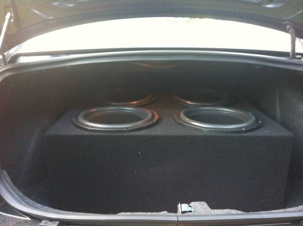

I bought 4 subs since they were a deal at $100 each, and I was impressed by how loud it was... actually was WAY more bass than I need lol. So I took 2 of them out and sold em to a friend, so now I'm only running two of them at a 2 ohm final load to the 1500D, so getting ~800 watts. And it's still plenty loud.
And this way, the spare tire compartment is easilly accessible since the box doesn't sit on where it folds up. And I half half my trunk left.

The car also had a spot in the rear deck where an 8" factory sub would go if it had the "premium" stereo. So I just cut out the sound deadener that covered it, and now the truck is vented into the cabin thru that opening.

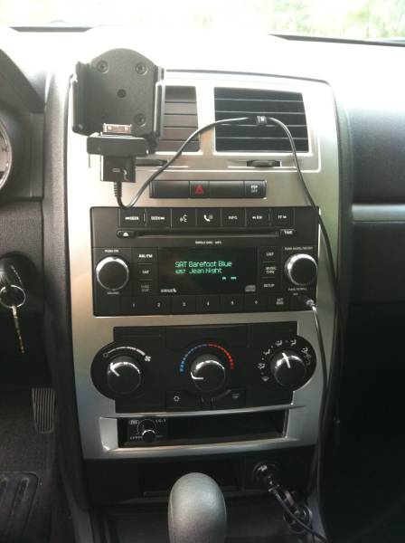

I used a PAC audio interface to get RCA outs from the factory radio. Here you can see the radio with my iphone mount, and PAC audio bass level control.

btw, what did you use to mount those amps on the back of the seats?

" what did you use to mount those amps on the back of the seats? "
Just hardware store zip screws into the metal frame of the seat back.

Is that the Xscorpion cable and connections, MS?
Did you have enough?

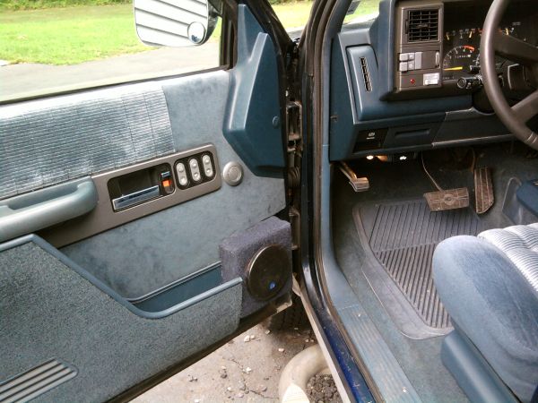

Hey those square ones worked great... lol. I recovered them in blue carpet and they are in the truck now haha. Both trucks have the same issue, no depth available in the door to mount speakers, stock ones are in the dash.
@ Canaan, Yes I used all the wiring and accessories you sent me, thanks man. Had to run down to the local audio shop for one extra set of ring terminals but that was it.
