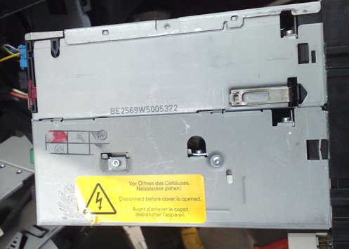

Totele
BE2569 and 5WK78101
you should be able to find the BE number stamped into the metal casing.Upload

Hi the becker serial will be stamped in to the metal casing like.
for the 5WK78101 you need Main Dealer or a Decode Service who will plug it into a laptop and electronically read/recode the memory chip (EEPROM)
