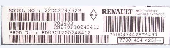

Username: Matrixxxxx
Registered: Jul-11
hello having changed the battery, the radio does not work, please send me the code?Upload
Username: Hay88
PortsmouthUk
Post Number: 3620
Registered: Mar-10
Matrixxxxx
code 7591
You must hold at the end to store your code.
IF YOU DONT HAVE ¬ KEY THEN PUSH THUMBWHEEL IN AND SOME HAVE {A¬} KEY
Turn on the radio and the display will show 'CODE'
Use the steering controls for code entry.
Press the [ ¬] button then rotate the thumb wheel for the correct first digit
Press the [ ¬] button then rotate the thumb wheel for the correct second digit
Press the [ ¬] button then rotate the thumb wheel for the correct third digit
Press the [ ¬] button then rotate the thumb wheel for the correct fourth digit
If the correct code is now shown on screen,
press and hold the [ ¬] button for up to 10 seconds to store the code
FOR NO STEERING CONTROL
press the first preset button for the 1st digit,
second button for the 2nd digit
third button for 3rd digit
forth button for 4th digit
then press and HOLD button 6 to store. for 10 seconds
and on some it's hold 5 to store.
