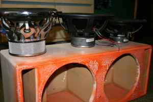

I recently aquired a couple of Audiobahn AW1208T subs as part of a trade. I tested the coils before I took them, but I wasn't able to hook them up at the time. All 4 coils read between 3.6-4 ohms.
I wired them up to my Planet Audio RXD1400 @ 1 ohm and the subs sounded awful and were hardly moving. On top of that aluminum cones were getting very hot.
Is this some kind of wiring issue I should look into or are the subs locked up?

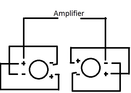

Hmmm, I am not 100% sure thats how it was wired or not. I will have to pull them out again to look. Could I still get a 1 ohm readout without having those 2 wires?
Alright they are wired up like my diagram above and bangin'. Although the input is turned down to about 1/3 because they drain my electrical like none other. I can have my SX at 1/2 all day and it wont drop past 13 volts. These Bahns need way more juice than I can push to them. Even though the sound quality still sucks, its noticably better than my last attempt. Thanks to all who helped me out, it is greatly appreciated. =]
No, since I have had them they have always been together in the same box. I got them on trade along with a couple other accessories. The box is dual chambered, I noticed when I pulled the subs out that one if the ports is about 3/4" closer to the back. Someone must have forgetten to account for the MDF thickness. Now I got them up on Craigslist, may be parting with them this weekend.
