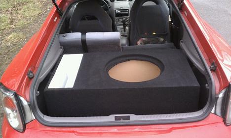

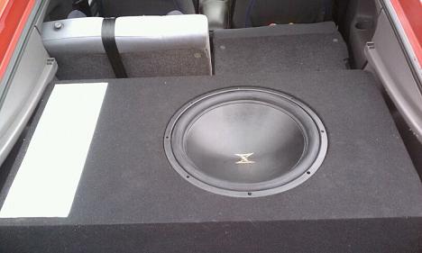

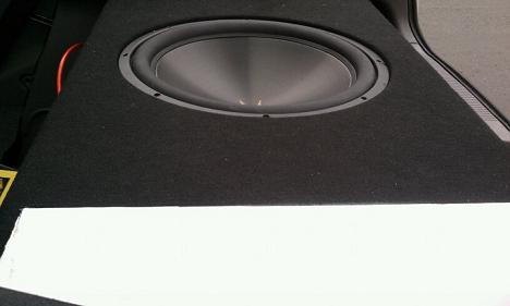

Enclosure came in. Rl-p installed. Pics and my review.
Username: Skdooley
Roanoke, VA Usa
Post Number: 1529
Registered: Oct-09
The enclosure Dustin made me found its way here today. It was packed really well, same as my last enclosure ordered from him and looked even better in person than in the pictures he had put up. He did great work as always. For its size, the enclosure really wasn't as heavy as I was expecting. I believe he used the super lite MDF or whatever its called, which is awesome. I used 1/4" threaded rods with locking nuts and washers to connect my speaker wire for the sub. Everything is nice and air tight. The sub also fit perfectly into the flush mount hole. I sat it in there just to see how it looked before I was ready to actually install it and boy was it fun getting the sub back out Here are some pics I shot as I was getting everything hooked up:
The sub for right now is running on 500 rms at 1.2 ohm. For comparison, I'll be referring to the 12w7 I owned before this sub. The 12w7 was in a 2 cubic foot enclosure at 32 Hz. This enclosure is 3.5 cubes at 30 Hz. I can defintely tell a difference in the extra displacement of both the sub and the enclosure. However, even though the sub is seeing the same 500 rms the 12w7 was, the rl-p isn't as loud overall as the 12w7 was. The rl-p however is killer in the low end, more so than the 12w7 was. There isn't a ton more low end output than the 12w7 had, but its there. I plan to upgrade my alt and run a full 1k rms to this sub. when I do that I'm sure it will make the sub that much more loud and to help it shine in every aspect. Overall I'm very happy with the sub. The bass is clean and clear, even running at ~1 ohm and the bass fills the car perfectly. There is more sensation of bass filling the car than I got with the 12w7, which there again is from the increased displacements.

3.5 cubes... are you not choking it? Have you considered a 15" or folding the rear seats down and taking up that space because damn - 3.5 cubes is on the small side for an 18".
edit: I could have sworn I read that this was an 18" ... I'm seeing things!
Username: Skdooley
Roanoke, VA Usa
Post Number: 1534
Registered: Oct-09
Haha, nah it's a 15. 3.5 cubes was what was recommended on the SS website and seems to be good for it. I'd like to have an 18 but if I ran one, I would have to go sealed. There's no more room in the trunk of my car I'm uploading a video now on youtube so I'll post it shortly. I ran the system full tilt, seeing what all it can really do. Pretty impressive to me. Where the enclosure is still freshly made, there is sawdust on the enclosure and the rest of my trunk. Nothing major, just some fine sawdust. You'll see it in the video haha.

Username: Snowball123
West Allis, WI
Post Number: 3626
Does nobody else notice the huge a** trunk cover covering up the port?
Should notice a big difference if you let that thing breath.
