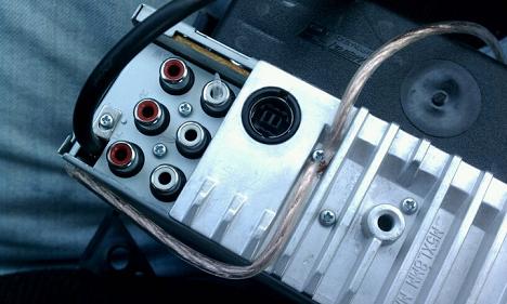

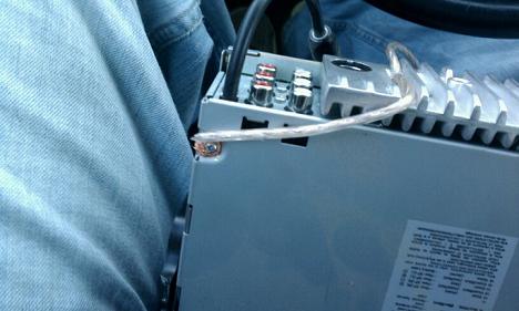

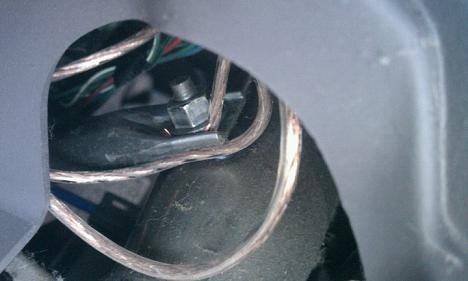

Ok so I just ran a ground from the casing of the head unit to a bolt I found that is on bare metal tubing. It looked like a pretty good place to ground the wire. I started my car and its still doing the same as it was, no different. I also noticed with the car off, and my keys on accessories that I can hear my fan spinning through my speakers also. The fan I'm referring to is the fan for the cars's heat and a/c. I turned the heat off and it quit. If I'm hearing my fan through my speakers could it still be my RCAs? I guess I could try running a ground to my battery but would that make a difference? Not sure what else it could be.
Username: Skdooley
Roanoke, VA Usa
Post Number: 1494
Registered: Oct-09
Here's a picture of the bolt I tightened it down to. I used speaker wire.
I connected the wire on the case in two different spots just to make sure I was connecting to the right part of the Head Unit.

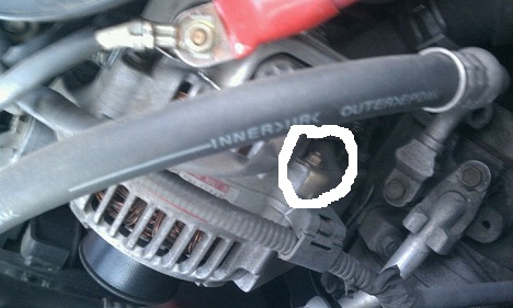

Someone had told me I may be getting alternator whine. They said to upgrade my ground for my alt. Is this something I should do? I have the spare 1/0 gauge wire to do it if so. I found a bolt on the side of the alt that looks to be a grounding bolt to me. I could hook up to the bolt and run down to the frame under the engine. What do you guys think?
Username: Nd4spd18
Philadelphia, PA
Post Number: 11703
If you have done the big 3 then your alternator is grounded good. The alt grounds thru the metal case, to the metal engine, to the battery, so the engine ground is its ground wire.
