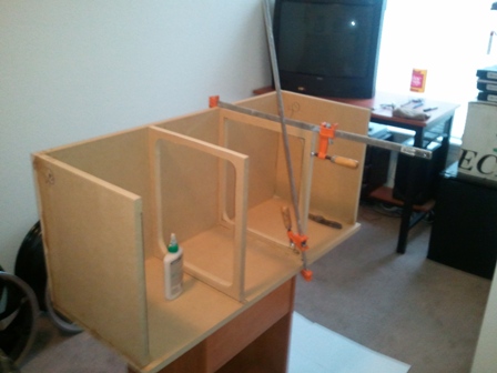

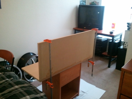

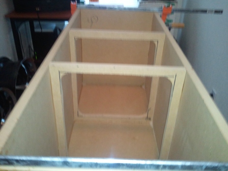

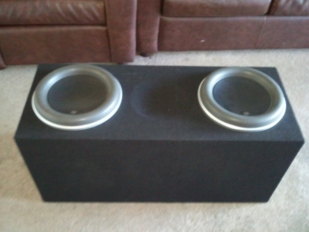

Username: Glowbox
Post Number: 76
Registered: Feb-10
Progress so far

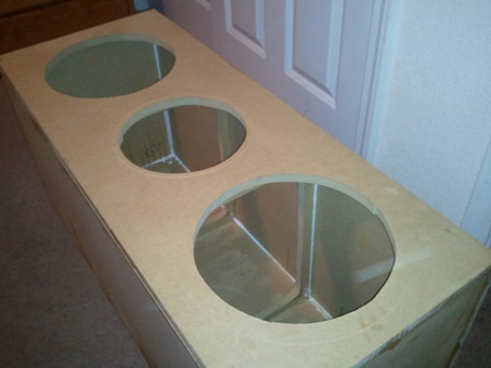

Username: Glowbox
Post Number: 77
Registered: Feb-10
Just waiting on the port to arrive now
Username: Gcs8
Atlanta, Ga
Post Number: 1922
Registered: Sep-09
looks good
Username: Jbpitt
Pittsburgh, Pa. Usa
Post Number: 1098
Registered: Jul-09
Looks pretty good man! Vid when you get it all setup?

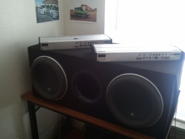

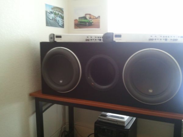

Username: Glowbox
Post Number: 78
Registered: Feb-10
Just put the port in hope to have everything installed in 3 weeks when it stays a little warmer out. Definatley will have a video
