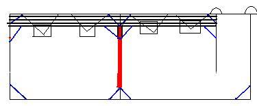

This is what I mean. The blue is bracing and the red is the middle brace.
This is the best I can come up with in a minute lol. The red is the port and the blue is the middle brace, missing 9 subs.

i would not bother with that. just get some threaded rod. 1/4 inch threaded rod in the middle and places around inside the box.
counter sink you subs if u can! and make sure to flair out the baffle on the inside and out were the subs set.
sounds like it will be a pretty solid box. what kind of subs r u using?
