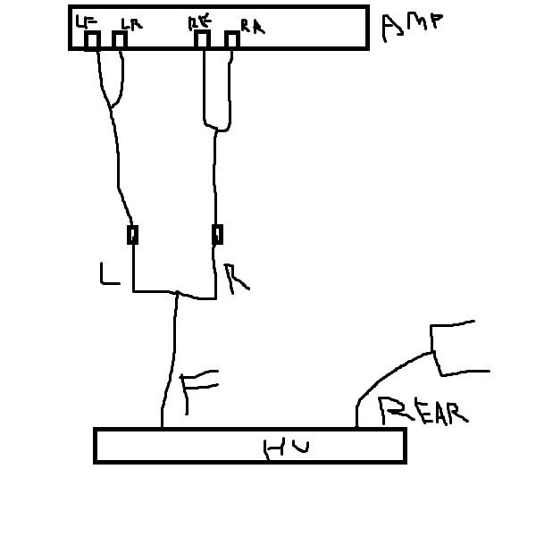

So I bridged my 4 channel amp into 2 channel and am just running my front components. Playing rap, it sounds fine. I had tested just turning my balance to all front and it sounded a little cleaner, so I thought I'd give it a shot. However, playing rock music, it just sounds like something is missing. I'm assuming there are sounds that only come out of the rear speakers, different than what is coming out of the fronts? I took the front RCA cables, got splitters and ran them to the front and rear hookups. Then on my deck I changed the balance to all front, since the rear isn't going to anything. That was the correct way to do it right?

EDIT I misread. You need to split the front RCA signal and connect them to both sets of inputs on the amp. Rear RCA lines are not used.
But NO, the sound from front and rear speakers is not different. Exactly the same. All standard audio systems are 2 channel stereo, a right and a left channel. Left channel audio goes to front left and rear left speaker, right channel audio to front right and rear right.

here...

It seems that all my sound is coming from my right side. When I turn the balance to the left, the volume goes down. When I adjust to the right it stays the same. It sounds weird because I'm not getting any left channel. I know I hooked it up right.. I split the front RCA cable right to the front and left to the rear.
Username: Skdooley
Roanoke, VA Usa
Post Number: 1301
Registered: Oct-09
It's as if I split the right side of the front RCA twice, but that isn't possible. How would both speakers be putting out the right side output?

Sounds like you have a bad connection somewhere.
If you properly split the right and left signals from the HU to the 2 channels on the amp, you should be getting equal power to both right and left fronts.
Try this.
Get rid of the Y-splitters...just for a test. Put the Left RCA into one of your RCA inputs for your amps front channels. Do the same for your Right RCA and rear channels.
See if the sound is equal for the fronts then.
Makes sure your gain and crossovers on the amp are set accordingly.
Also, what 4ch amp do you have?
Some amps have a 4ch/2ch option that internally splits the signal to allow for a setup like you are trying to create.

It's a RF 4004. I've got the button pushed in that sets it for 2 channel mode. It's never been ran bridged before. I'm going to try your advice and see if I can figure it out. My components you asked about are the 6.5 pioneer rev series, 60 rms.

Ah, if the amp has that 2 channel mode you shouldn't need splitters.

Ok, I see whats going on here now. You have your RCA's set up wrong w/ that P4004.
Here is what you should do.
-Keep your RCA Y-splitters in place just the way you have them.
-Take the amp out of 2ch mode and put it in 4ch mode.
Problem solved.

The advice on turning the amp back to 4 channel worked. I hit the button and it solved the problem. I believe if I was just to run the front RCA's to the front channel input, then select 2 channel mode, it may have worked as well as MS had recommended.

Actually, the trouble shooting thing I posted was to help test for the very problem my 'switch flip' method fixed.
Your 2 right RCA's were just doubling over to from the amps front channels to the rear. So, when you faded to the left, you lost pretty much all sound.

If your HU does not have time alignment, keep the y-splitters in place if you want to retain the ability to balance left and right.
By splitting the HU's front RCA out to the rear and front inputs on the amp, you effectively force those inputs to react as left and right rather than front and rear. With some 4ch amps, the inputs react as if your HU only has a single R-L RCA ouput. If you put your RCA's directly into the ch1-2 inputs and put the amp in 2ch mode, you may loss the audibility to balance L-R.
Of coarse that all depends on how the RCA summing/input/output works on your amp.
Best to just keep the splitters in for now. As long as you a happy w/ the loss of rear fill. You may want to run the rear speakers directly to the rear speaker outputs on the HU as MS recommended. That may allow for a little 'ambiance' given the much lower power output of the HU vs the amp.
