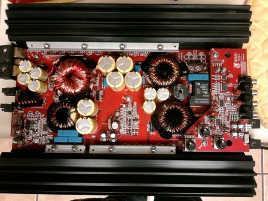

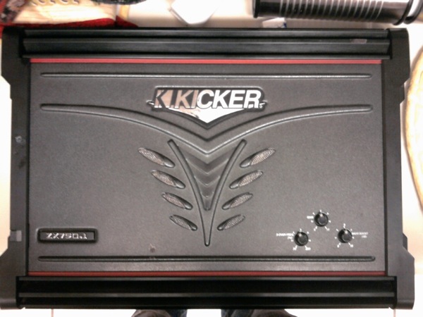

Well here is a pic of the amp i have and another of its interior... hope this helps!

gain could be turned too far up, wiring (ground) cound be loose, or you could have a cold solder joint on the PCboard.

I already replaced the RCAs and the problem was still there and the amp has been mounted on the back of my sub box... as for the gain it is only up half way and well i checked all the wiring but i might hook it all up again to see wat happens. Sry for the ignorance but cold solder joint?
