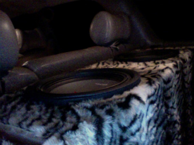

Right now I have 2 Alpine Type-R's (12") wired to a Soundstream TRX1500D. I built my own upfiring box for them and put them in my 2001 denali.

the BL's are nice subs, but you may be able to fix your lack of feeling the bass by making a new box. can we have some specs on the box? maybe a picture of it? other wise you may just try 1 12" or 15" BL and wire it for 1 ohm in a nice ported box.

Username: Iamjacobriley
Registered: Oct-10
The box is ported with separate chambers with no back seat.
The Dimensions: 45" Width, 20" Height, 14" Length
This includes the 2" ports, all made with 3/4" MDF and is a lot better, in my opinion, than the professional box I had before.
It's loud, don't get me wrong, but the feel is still lacking.
Sorry about the pictures, they were taken tonight.
The fur is added for fun.

Most likely the fur is killing it.

the box is too large, and the ports are too small for a pair of 12" Type R subs. As noted before, the problem is the box.
You should have 2 to 2.25 cu ft per sub, and you need 4" ID ports (round) for twelve-inch subs.
