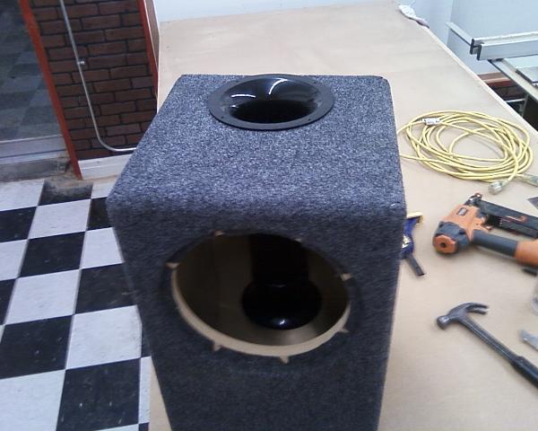

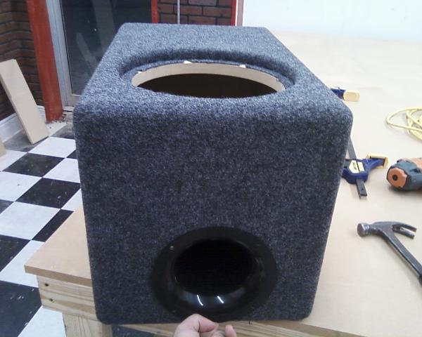

First, the little box... 1-DD1510a D4, 1.5cuft, 36hz, 1-4" PSP port. Going in a customers H3 w/ stock HU and DD C2b amp @ 2ohm.
Big smooth 3/4" corner round over.

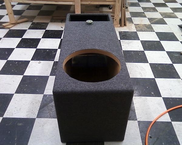

Now the big box. DD3518F D2. Going in an '04 ext cab silverado on an M1B. 7.35cuft, tiny little port.
Has the same 3/4" corner round over, but it doesn't look as dominant w/ this bigger box. Every wall of this box is 1.5" thick except the bottom. Its a heavy *****.

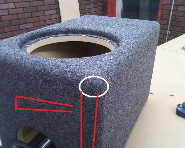

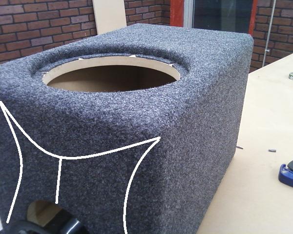

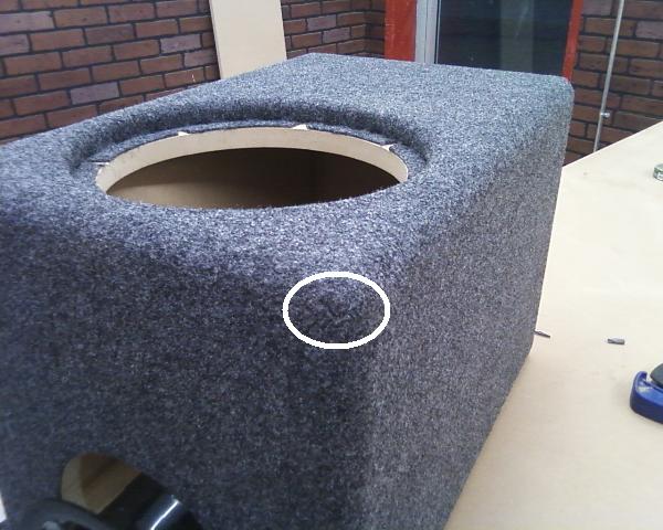

I also paint staples black and shoot one in each corner to hold those seams together and keep them from coming up later on. You can see one of the staples here:
The staples are hidden very well, you have to catch the light just right to see them.

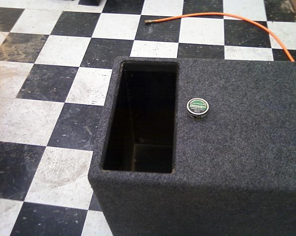

Oh...and their are a total of 5 seams on the face w/ the port. Dare you to find them
Also, in this picture....you can see how I round over the slot ports and recess the bit ~3/16". That way you get the rounded port opening, but I shoot the black painted staples into the ridge that the router bit makes.
I then trim the carpet back and burn the cut edge to clean up any frayed ends. It also help to make the carpet shrink up around the staples and 'bite in' so the carpet doesn't pull up around the port later. I know alot of people just trim the carpet around the port, but this helps alot to help the lifespan of the carpet around the port.
