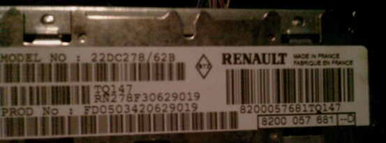

hi, my radio is blocked and requiered a block code.
Can anyone help me, please ?
I attached my date serial
tnks.

your code 9865 you must hold at end to store code.
Code Entry as Follows:
Switch Radio On - Display Shows
" 0000 " with the 1st digit flashing
Rotate " Thumbwheel " For Correct Digit
Press " " On The Stalk Control To Enter
If the correct code number is now shown
Press And Hold " " Until A Beep Is Heard

tnks tnks tnksssss.......... my radio is on airrrrr..
good job
