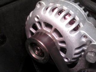

Got my new pully. Its slightly smaller than my current pully. Only trouble is now i need to go out and buy an alternator pully removal tool. Unless someone knows how to do it safely and without buying any special tools.
You can either take it to advance or a tire shop and ask them to pop it off with an impact wrench. It probably takes a 7/8 socket. Most places will do the swap for free or like 5 dollars.
If you have an air compressor you can buy a used wrench and socket set for around 50 dollars if you shop around.
Well I went to Murrays/Orielys and they said they would do it, but I would have to take the alternator off and bring it in... Well I cant do that since I only have one car.
The nut on my alternator is 24mm and it is threaded to a bolt with an allen head on it.

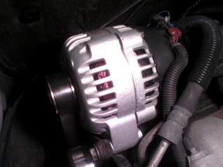

What output alternator is that? After seeing the picture I'm going to agree with ms, if you don't have enough output after swapping pulleys upgrade to the ad244.
I would try another shop to see if they'll do it if you remove your serpentine belt.
I got it from Motor City Reman. It is supposed to be 200amp, but I cant be sure since it came in some random alternator box with 200amp litterally written on it. I dont wanna trash talk MCR, but Im not sure if I would go with them again just because I am not positive what they gave me. I went with them because glasswolf recommended them, they were the least expensive 230free shipping, and I wanted to support a local business.
Troy, thats a truck alternator. I dont think it would fit.

a CS144 can be put on most vehicles with a CS130 stock, just have to get one with the correct mountings to match the stock one. as long as the clearance in the engine bay is there it is easily done. just need a longer belt. but in your pics it looks like space is limited so maybe on yours it can't be done.

I got the new pulley on yesterday. Seems to be doing the trick, my voltage stays above 13.8 even on the strongest bass hits. Always at 14.2 or higher at idle with nothing playing(14.4 or higher while driving). My voltage was actually up to 14.9 for a while this morning.
