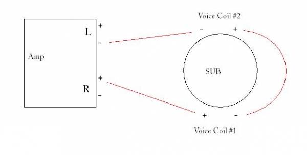

well... the important spec when it comes to matching subs and amps is the RMS wattage not the max (this number is for show and means nothing). Cant really find any info on that amp.
you really only have one option tho because your sub is a dual 4ohm and your amp is only stable to 4ohms bridged, you cant bridge it in parallel because that would give you a 2ohm final load, that would fry ur amp most likely. You need to bridge it in series.
You have 2 Voice coils on this sub, hook 1 wire to the positive of the channel 1 on the amp to the positive of voice coil #1, then cut out a small wire and jump the negative of Voice coil#1 to the positive of Voice coil #2. Finally hook up a last wire from the negative of voice coil #2 to the negative of channel 2 on the amp..... heres a crappy drawing.
the amplifier should have instructions on how to bridge it. Follow those instructions.
