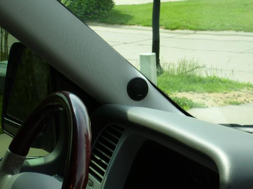

I've thought about molding the tweets in the A Pillars. I did it in my last vehicle and liked the look/sound.
