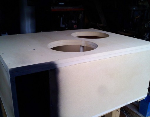

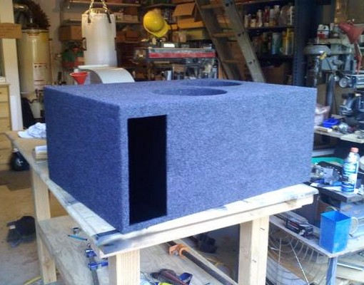

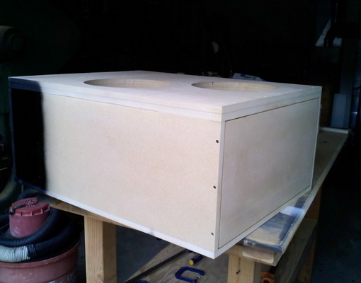

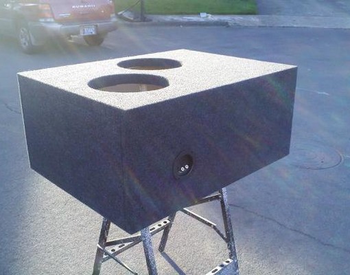

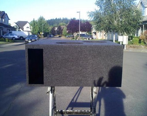

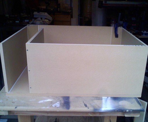

Hey Everyone, this enclosure is for Zeke's 2 AQ SD2.5's. Box is 4.5 cubes @ 35hz with around 15 sq inch. per cube. Will have charcoal carpet. Enjoy the pics!
Note to Ecoustics members:
Starting this week (this enclosure) I will be using 3/4" Trupan light MDF on ALL of my enclosures, this will not only get you as the customer a better price because it weights 60% less than regular MDF and also give you a much lighter enclosure for your car. Shipping for enclosures will be extremely cheap due to the weight and since Ecoustics is where my real home is, I will be giving all Ecoustics members who want a custom enclosure (I design and build) 10% off of the original price. This paired with the fact that shipping is cheaper will yield an extremely great price for an enclosure. My email is DLaudiotech@gmail.com Thanks!
Username: Cwruck
Post Number: 282

Now just to carpet...

Username: Dustin3
Box Designer & Builder...Dustin
Post Number: 5676

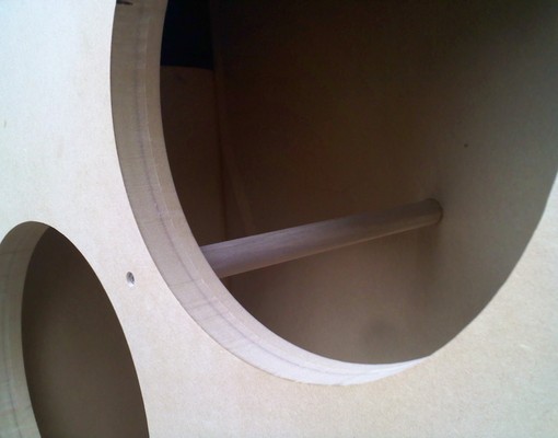

Here are the final pictures. Enjoy

turned out very nice man, once again.
Username: Skdooley
Roanoke, VA Usa
Post Number: 910
Registered: Oct-09
That's going to look so good when the subs are mounted into it. Whomever's box this is needs to post install pics and video

Username: Dustin3
Post Number: 5677
Thanks! and yea, hopefully Zeke will comment and get a vid and some pictures of this thing!
