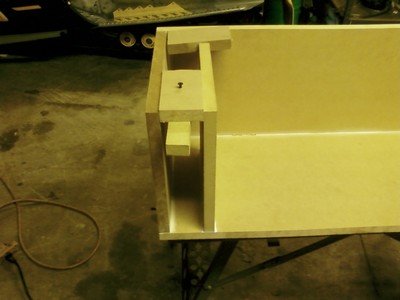

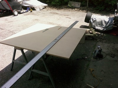

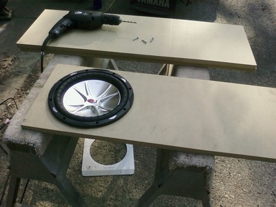

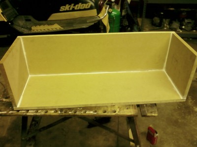

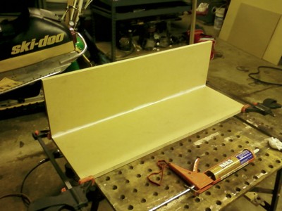

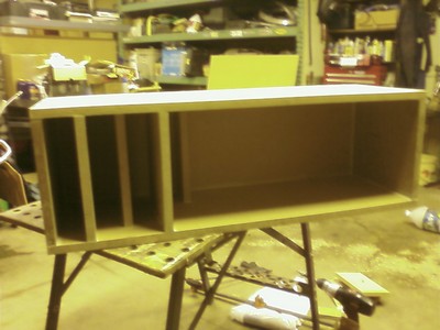

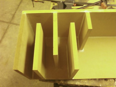

here it is, pictures speak for themselvesUpload
Username: Schinner
Post Number: 99
more

Holy long port
Nice work man!

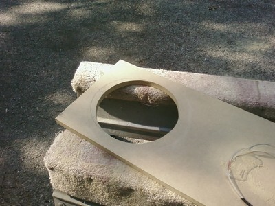

Suggestion:
I see that in your fourth picture you actually "cut-out" the hole for the port, then placed the whole front baffle on. There is no need to cut out the hole and it seems that would take some extra time to do. If your just changed how the individual panels fit together, it would have been alot easier. I can do a picture up for you if you would like.

whats a front baffle? and what does it do? should i tell my box builder to ad a front baffle?

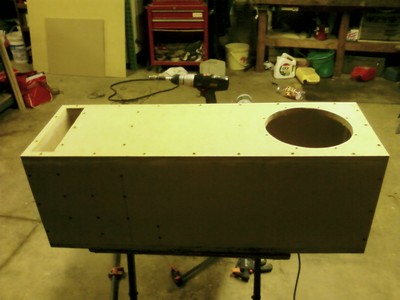

finished product looks decent

is that a 10" ?
im guessing the port is too long to be ran straight down the back wall ?
but nice neat construction though ......
Username: Schinner
Post Number: 100
actually no lol...port would have fit fine along the back wall...just wanted to switch it up a bit.
yes that is a dvc 2 ohm kicker cvr 05' model
the front baffle is like that simply because i didnt want screws going IN towards the sub (yes it took a lot more time to do and isn't quite perfect yet)....the port is 42.7 inches long, 26.25in^2 port area....final tuning should be right around 30.52 hz...depends on the volume the sub takes up (i assumed .05 cubes) ...and precision of cuts, which were VERY good this time...none of the cuts were more than 1/16 off. i still have sanding and carpet to do.
