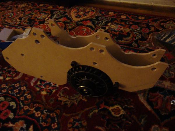

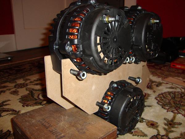

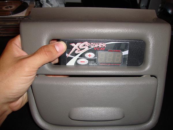

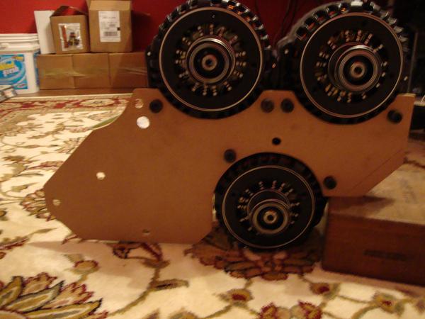

The hardest part for me was finding parts since there's 1 junk yard in like 50 miles. I'll be 'glassing part of the center console soon too, that'll come along with the quad bracket to house the vcm:
I'll try to keep this thread up since I lost my build thread.
