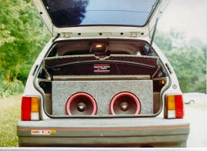

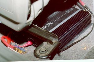

Honestly I'd see how much I had to spend, then find the best amp I could get in that price range. I wouldn't try to buy the biggest amp I can find. I'd go for quality over quantity in this case. 3Kw is a lot of power. More than you really need, honestly. You'd need an upgraded electrical system to handle that much power, and I don't think it's really needed when I had a system that had a total of 320 watts RMS in one car on 2 12" subs in a ported box, and I was hitting over 140dB, and that was 18 years ago.
kids today have an over-exaggerated idea of what you really need to get a loud system. I had 14 speakers in that car, 2 amplifiers, and both were class AB (not super efficient) and I was only drawing a total of about 70A @ 140dB+

are those funky pup subs?

What are you on Crack Death noob?

its a tiny pic on 1920x1200

That fiesta had quite the system.

Those pics were taken in 1992. Those were treated paper cone, foam surround cerwin vega LE-12D dual 4 ohm coil 12" subs.
power handling was 125WRMS per coil. Sensitivity was something like 92dB @ 1W @ 1m
Anyway, power is relative, in that if you don't want to be required to use huge amps, then choose very sensitive speakers. You'll get more output per watt that way. That's all I'm saying.
