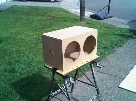

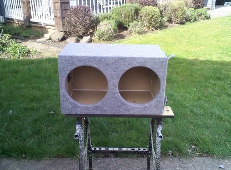

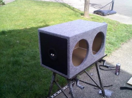

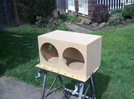

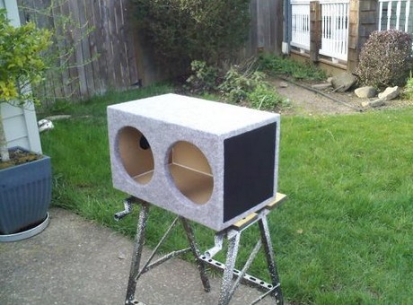

Getting these pictures up a little late but this was a build that I finished for Andrew R. It is a sealed box for 2 10" RE SE's. Here are the pictures. The last picture is my official logo when my website gets up and running

very nice, how many Cu ft?
Username: Dustin3
Box Designer & Builder...Dustin
Post Number: 5453
1.25 cubic feet.

two ideas for future builds.
If you inset the side panels maybe .5 to 1.00" on both sides, when you cover the box, the lip left will act as a handle to lift the box.
If you use a router to cut those holes for the subs, you can route an inset there, too, so the subs sit flush when they're mounted. It makes them look a little more professional when everything is done.
box looks great.

Glasswolf ~
Yes I know. I do both insets or rabetting. I know you have been gone a while but I have had many build logs of different kinds of builds where I do everything from flush mount to insets. Thanks for the look out though!

cant see any screws so do u use staples & a strong glue or do u putty over the screw holes ...
Username: Dustin3
Post Number: 5467
For smaller enclosures I use Titebond II and clamps (like this one) Rovin. Anything bigger I use screws and Titebond. I'v done many many experiments on the strength of titebond II and clamps and It's quite amazing how strong it actually is.
