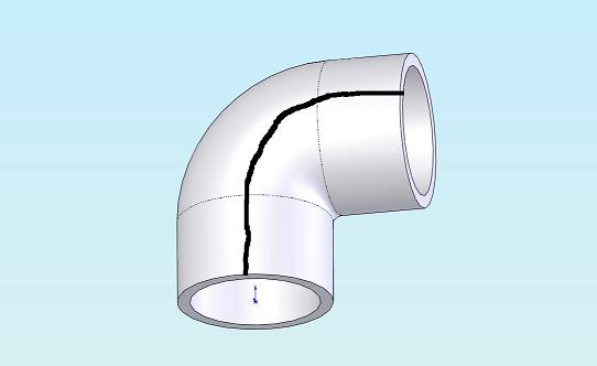

well i was asking how you secured the port in there which you already answered
but also, i was wondering how you measured the port area with the elbow in it?
Username: Rovin
1 15 = 152.5 DBs ...Trinidad & T...
Post Number: 16060
well internally the elbow has the same port area as a cross section of pipe
in case ur wondering about the length of a elbow or even 45 degree bend u have to measure it along the middle like this : ...
Username: Kyle_lowe
Post Number: 972
Registered: Apr-06
ah ok, it makes sense now that you explain it
thanks
