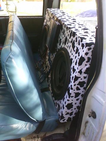

Ok so i shoved some memphis pr15d4's Behind the seat of my 87 s10 andi just noticed that they are kinda rubbing and making a squeking sound and i know this must be bad for the subs any idea what to do? I really dont want to down size....
Heres a pic for refrance
http://i47.tinypic.com/2dhz7sh.jpg

haha what the phuck is up with the cow theme dude lol
My friend had the SAME set up in his truck and the same prob and it didnt really bother him/his system.. but even if it did effect it he didnt give a damn.

Move the seats up and get some grills on them is all I can say.
Short of that call it the Gateway mobile?

The seat is up as far as it will go and what grills can you recommend?

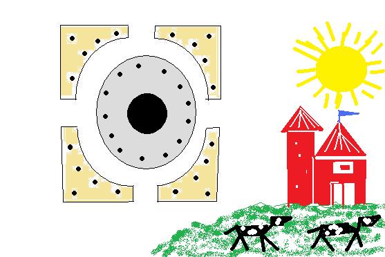

@ the cow theme
http://i48.tinypic.com/2a6tmy8.jpg
should explain a little xD

flush mount the subs. you might lose a tiny bit of volume but it wont be audible.

i guess i didnt think about the fact that you probably dont have a double baffel (all my boxes i build double baffel). If you dont then yea you need to build a new box.
If you have a double baffel it would involve a router and a circle jig.
all you do is cut away at the baffel in a large enough diameter so that the outside of the sub and gasket will fit into the new hole. obviously you need to leave wood so the sub dosnt fall into the box so dont go all the way through hence why you need a double baffel.
only other thing i can think of is to get grills or belt sand the bottom of the box to drop the box down a bit until it fits. If you need to you can belt sand the back of the box too so the box will move away from the seats. I figured doing the bottom would be fastest since its the least area to sand but doing both will obviously give you the most room. either way sanding will take a long time and will only be a slight change so it may not be enough.

really Im thinking about just screwing some wood blocks to the box to space the seat from the sub just in certain spots because im already up AS FAR as i can go im rubbing the wheel xD

its not so much the clearance as it is the back of the seat so i think if i put like 4 wood blocks around the sub in a square shape i should be good but im not quite sure what do you think?

Well it seems to me you need to do something to keep from ruining your subs. A new box is what I would do.

There's no other way.
Make a new box.

Take a 8 pieces of wood that are a lol bigger the the excursion on yr driver and nail/screw/however the f**k you wana do it and put a piece above/below/each side of the driver and there you go buddy, sand the edges down so it's not f***king yr seat in the acehole.

And op, No need to have a cow about it, I would grab it by the horns this way.
Ok, One way to milk it is to cut the front box opening so the subs will flush mount inside, giving you 3/4 more room before it hits the leather. Then make a new mounting flange to remount the subs inside.
It wont look as cheesy and should be tits to make these. If you arent good at wood working you could farm it out, But Hay, nothing to lose.

And OP, If you cut the new mount in half, 1/3 or 1/4 pieces to get it into the sub opening with out taking the box apart.

I didn't even notice the amp mounted on the box. Flush mounting the subs won't prevent the seat hitting the amp. With the seat up against the amp do you have enough ventilation for it? It also looks like you might not have any room inside the box for a flush mount anyway. How much clearance is between the motor and the inside rear of the box?
Again grills seems to be your only bet.
Diamond Member
Www.stainles... .ecrater.com
Post Number: 22038
Oh and Marc has a good suggestion if you have the room inside the box for it. You can always make some MDF rings to give you the inside mounting flange to deal with the single baffle. Again though none of that will protect the amp, which appears to be deeper than the subs anyway.

I use the amp to kinda push the seat off of the subs they are getting the air but its that damn squeaking thats pizzing me off and the rubbing thats scaring min
