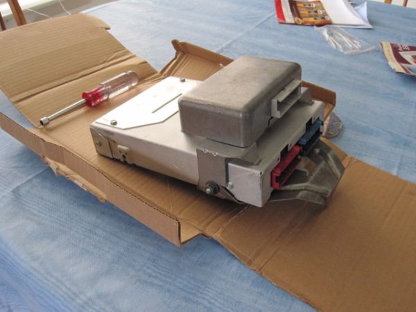

The PCM is under the passenger side dash with a bunch of other electronic controls. Pull off dash underside cover, kick panel cover, pull back carpet and there it is.
PCM unit out of the vehicle

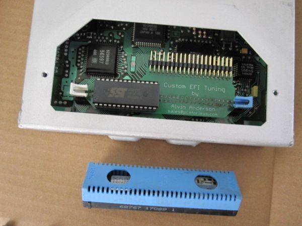

That thing with the blue cover is the stock chip
Pulled that out and plug in the new one into the slot
Put the unit back in the vehicle and that's it. It makes a noticeable difference, the truck feels like it has more power now from the higher shift points, and a bit more top end power from the lack of EGR. The 1-2 shift especially is now firm and quick where before it would hesitate. I'm happy with the result... worth the $200 for the new chip? Not quite sure. Definitely an improvement just wish it cost a bit less.
