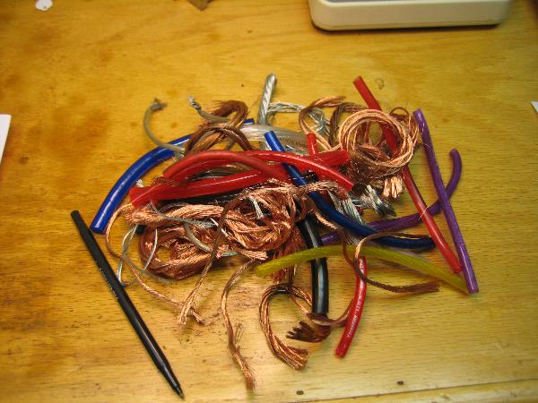

Bunch of scraps.

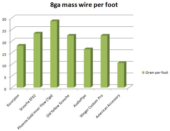

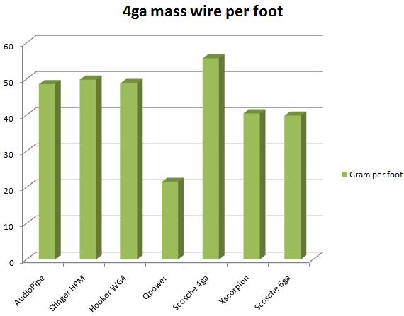

Wire masses
Charts
Take this as you will. I would love to know the copper purity in these wires.
The Qpower wire #'s where pretty much what I expected. Less than half of the other wire's average size. The Scosche wire really surprised me though.
