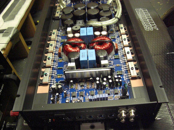

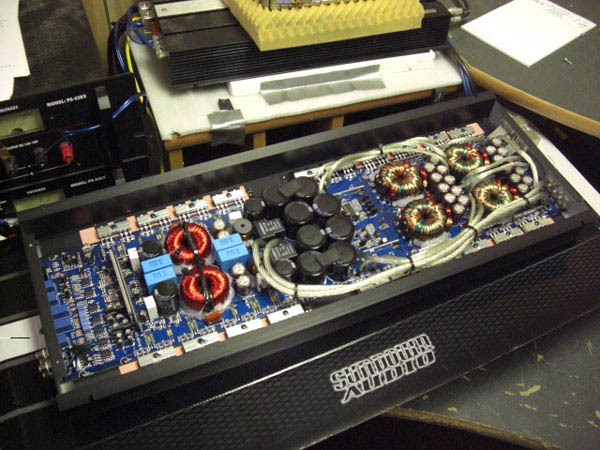

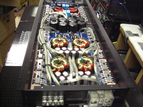

Bronze Member Username: SundownzMooresville, NC USA Post Number: 11 Registered: Nov-06 | I did the 16v testing myself, Derrick on Team Sundown did some 12v testing, and Raymond Farmer (well known from dB Drag) also did some 12v testing. My testing and Derrick's was done using my Extech True Power meter - it reads out a power figure a full ~6 seconds into the burp so there are no artificial peak numbers. http://www.extech.com/instrument/products/310_399/380976.html Ray's testing was done with his own equipment. ----- My HIGH VOLTAGE TESTING: 6x Powermaster D1000s used for testing 17.9 volts rest - did not measure voltage drop. 10,320 watts from the pair @ 1.5 ohms each after rise starting at 0.5 DCR 5160 each 11,470 watts from the pair @ 1.3 ohms each after rise starting at 0.5 DCR 5735 per amp ----- Derrick's 12v SYSTEM TESTING: Starting battery + 2x Powermaster D3100s used for testing 3980 @ 0.25 rising to 0.65 @ 11.2v (engine on) 2050 @ 1 rising to 2.44 @ 12.2v (engine off) ----- Ray Farmer's 12v Testing: Okay, I have done my SAZ3000D 12volt power test. I would like to say, WOW!! My nominal ohm load was 0.5 ohms. I did plenty of test but I got the amp to do its power at the proper settings and did 3 test and took the average. I used 2 x NSB-g3100 to power the amp, Starting voltage 13.2 Test 1 75.1 volts 39.9 amps 2996.5 box rise 1.88 voltage drop 12.2 Test 2 75.1 volts 37.7 amps 2827.5 watts box rise 1.99 voltage drop 12.1 Test 3 76.0 volts 39.5 amps 3002.0 watts box rise 1.9 voltage drop 12.1 Average of 3 test 75.4 volts 39.03 amps 2942.86 watts box rise 1.92 approximately 2 ohms So 2942.86 watts @ 2ohms @ 12.1 volts That is some power!!! ----- Original thread link here : http://www.soundsolutionsaudio.com/forum/index.php?showtopic=28412 ----- The whole first run of these sold out already but I figured I'd share some testing anyway ![]() ![]() ![]() ![]() |
