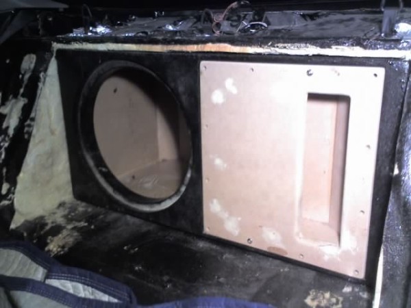

I didn't cut the back deck out but the steel support below it. You can go a max width of 36" that is basically what you have between the strut towers.Needless to say that any and all box placement once you get that big will be from cabin only lol. The box seen is actually 35" by I thin 17 or 18" high. Invest in a sawzall that made my whole job a lot easier. I used 5" L brackets and stainless screws plus I used card board formers and expanding foam for the tops and sides. The whole underside of the back deck where the speakers were are all stuffed with xpanding foam. If you notice I didn't cover up the fuel pump access hatch just before the box :-)

Thanks for the info. I will probably cut just what I need in order to fit the box through, which will depend on what sub(s) I go with. I need time to think all this through lol.
